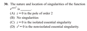

Singularity is where function is not analytic means we can't differentiate denominator. It tends to 0.
expanding e^-1/z^2 = 1 - 1/z^2 + 1/z^4 - ...
This has essential singularity at z = 0 as that's where the denominator goes to 0.
but book answer is B. How?

I think that is a typo. You are correct.

What happens at ##z=0##? And why shouldn't we be able to differentiate it there as often as we like? The graph is pretty flat in a neighborhood of the origin.

And what happens if ##z=it## and you let ##t## go to zero? The language of the problem seems to imply we should think of it as a complex function.

Don't say things like e^(1/0) and e^(inf). That's sloppy. And it's not even true. You know the limit is zero if ##z=t## where ##t## is real. The limit is UNDEFINED. But yes, the book is wrong.

Should answer be C or D?
I think it's C. Non-isolated singularity means like there are many other singularities neighboring 0 but that's not the case here. At z = 1, the f(z) becomes 0.368.

Yes, the function is well behaved except at the single point ##z=0##. It's C.
