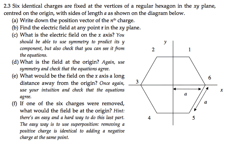

The discussion revolves around a homework problem involving six identical charges arranged in a hexagonal setup. The user has attached images of their work but acknowledges a mistake in part (b) and seeks assistance in identifying it. There is confusion regarding how to account for all six charges in the calculations for part (b). Participants are encouraged to provide guidance on correcting the error and clarifying the orientation of the setup. The focus remains on resolving the issues related to the hexagonal charge configuration.

The orientation of the image looks wrong.
How do you take into account that there are 6 charges in (b)?
