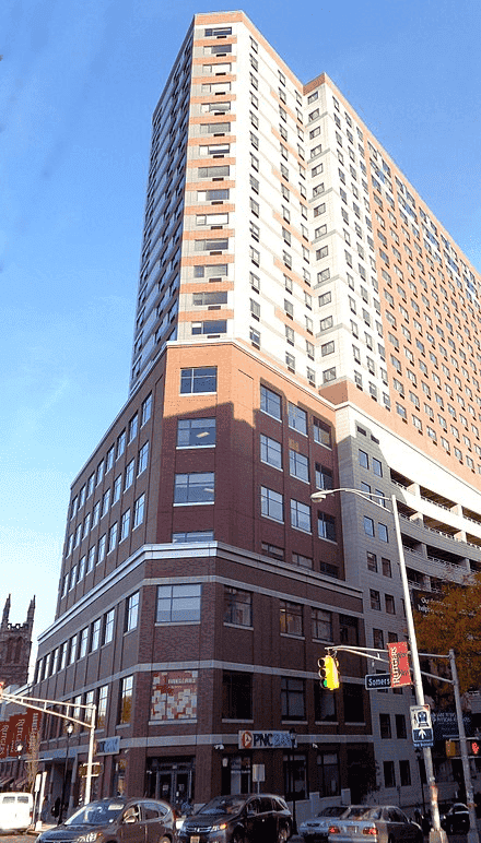

Here's a clue as to the size you need.
https://en.wikipedia.org/wiki/Corner_reflector
Corner reflectors can also occur accidentally. Tower blocks with balconies are often accidental corner reflectors for sound and return a distinctive echo to an observer making a sharp noise, such as a hand clap, nearby.
A simple web search for sound reflectors reveals many sites, most of them commercial, but which have essays on reflecting versus absorbing sound.
