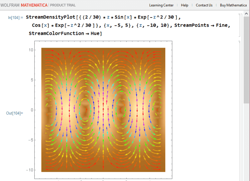

Mathematica lent me a copy for 2 weeks, that was nice of them. After an embarrassingly long time I came up with a plot of the electric field of the equation above with y=0 and with the above equation converted into a linearly polarized beam. The magnetic field is the same, just rotated 90 degrees about the x axis.
Field lines end and I can not figure out how to force them to continue, seems there is some maximum density that I can not override for now. Remember the divergence of the electric field is zero with no sources, field lines should form continuous loops. Also note the overall vertical scale should be stretched so that the beam is many wavelengths wide as per problem 7.20 above. Any suggestions on how to improve the above plot? I tried way too long to use VectorPlot3D but could not get any good results.

Cutter Ketch said:
So, yes the electric field from each emitter must curl around like a dipole field, but superposition and interference allow that to be negligible in the intense part of the beam.
So what I plotted is correct or incorrect given the caveats?
  • #39
Although you had the correct idea that Maxwell's equations won't allow an E field to be truly be 100% transverse polarized, I think I would have to say your drawing was incorrect.

The function I tried to graph was taken from a problem from Jackson's Electrodynamics. He gave the result, the problem was to prove the result. I just used the result Jackson gave. Because the transverse electric field of a beam of finite width most go to zero away from the beam and using the fact that the divergence of the electric field is zero I don't think any other result works, I think the electric field must have the form that I plotted? Granted the field plot must be stretched vertically but that does not change the basic form.
