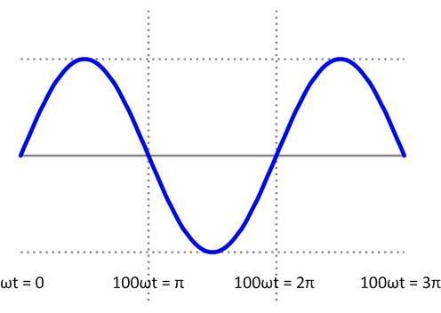

Having some trouble with this question,
A complex wave is described by equation, y=100 sin ωt+30 sin(3ωt-∏/2)
A) on the same axis sketch and label,
1)one cycle of the fundamental waveform
2)the third harmonic
3) the complex waveform(y)
ω=2∏f
T=2∏/ω
Not sure where to start.
To sketch graph I need to find time, to get time I need frequency. Not sure how to find frequency from 100 sin ωt
as
Do I just treat ω as 2∏?
No, you treat ##\omega\, t## as the x coordinate.
Ok so I have ωt, ωt/2, ωt/3 along my x-axis for my time coordinates ?
If you still feel uncomfortable, choose ##\omega = 1##, make the y, t plot and then rename the t axis to ##\omega t## axis !
Where I'm getting confused is I'm used to solving the likes of 100 sin (100 ∏ t)
from there you get time=20ms, so you can plot the time axis up to 20ms.
I don't understand how to plot ωt
Perhaps I confused you earlier on, sorry. There is no solving involved, just plotting. One period in A1 -- so from ##100 \, \omega\, t=0 ## to ##100\, \omega\, t=2\pi ##
