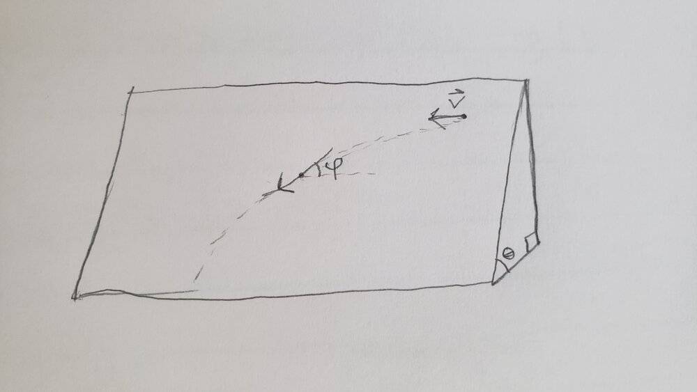

A block is placed on a plane inclined at an angle θ. The coefficient of friction between the block and the plane is µ = tan θ. The block initially moves horizontally along the plane at a speed V . In the long-time limit, what is the speed of the block?
ms˙ϕ˙ = mg sin θ cos ϕ
This question is from the David Morin ( Classical Mechanics ) - problem 3.7. I spent some time trying to figure it out the solution by myself, but since I couldn't, I looked into the solution in the book, but I got even more lost. So I searched for an online solution that could help me at least visualize the problem, and I found two solutions here, one here, and some one that already asked the same question here. There isn't any pictures of the problem anywhere, so this is my interpretation:
I get that the forces down the plane cancels out, and the equation for the acceleration in the tangential direction: m(ds^2/dt^2) = mg sinθ (sinϕ − 1).
But in the equation for the acceleration in the normal direction: m(ds/dt)(dϕ/dt) = mg sinθcosϕ, why the normal acceleration is (ds/dt)(dϕ/dt)?
And why the acceleration in the y-axis equals the negative acceleration in the tangetial direction?
Remember that this occurs only in the large-##t## regime; at the beginning, the ##y##-components of the two forces do not cancel out, otherwise, ##a_y## would always be zero!
Or perhaps you mean the forces perpendicular to the plane? Those do indeed always cancel out.
Notice that$$\frac{d\mathbf{x}}{dt} = \frac{ds}{dt} \frac{d\mathbf{x}}{ds} = \dot{s} \frac{d\mathbf{x}}{ds}$$and hence that$$\frac{d^2 \mathbf{x}}{dt^2} = \frac{d^2 s}{dt^2} \frac{d\mathbf{x}}{ds} + \frac{ds}{dt} \frac{d^2 \mathbf{x}}{ds^2} \frac{ds}{dt} = \ddot{s} \frac{d\mathbf{x}}{ds} + \dot{s}^2 \frac{d^2 \mathbf{x}}{ds^2}$$but since the tangential unit vector is ##\mathbf{e}_t = \frac{d\mathbf{x}}{ds}## and the normal unit vector satisfies ## \kappa \mathbf{e}_n = \frac{d\mathbf{e}_t}{ds} = \frac{d^2 \mathbf{x}}{ds^2}##, it follows from the chain rule that, since ##\kappa := d\varphi / ds##,$$\frac{d^2 \mathbf{x}}{dt^2} = \frac{d^2 s}{dt^2} \mathbf{e}_t + \left(\frac{ds}{dt}\right)^2 \frac{d\varphi}{ds} \mathbf{e}_n = \ddot{s} \mathbf{e}_t + \dot{s} \dot{\varphi} \mathbf{e}_n$$which tells you that the tangential component of acceleration is ##\ddot{s}## and the normal component is ##\dot{s} \dot{\varphi}##.
Since the components of force perpendicular to the plane cancel for all time [i.e. the motion is strictly rectilinear], you've essentially just got a particle acted upon by a component of weight ##mg\sin{(\theta)} \mathbf{e}_y## acting parallel to and down the plane, and a friction force ##-mg\sin{(\theta)} \mathbf{e}_t## acting in the negative tangential direction.
If you draw a diagram of this, looking directly down on the plane [i.e. in the direction of the plane normal], can you see why ##a_y = -a_t## when you draw the forces?

Aaaah, yeees. I see it now! Thank you very very much :)
