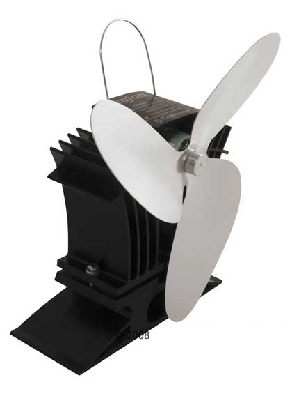

I saw the awesomest, simplest device evar sitting on my friend's wood-burning stove. It's a convection fan powered entirely by heat.
Bottom gets hot, top stays cool. Difference causes electricity to flow, powers fan.
Hey Dave. I went to their http://a1stoves.com/" wondering what the temperature difference needs to be for normal operation and couldn't find anything. Do you know any of its specs?
I dunno. I do know that it works sitting on top of a wood-burning fireplace.
