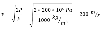

(1) The length of the 1 mm bore is not the only thing that is different in each of the three nozzles .
(2) Calculate the theoretical flow velocities and see if there is any correlation with your measured ones .

(1) The plan was testing nozzles with three different lengths: 3 mm, 10 mm and 20 mm. In the product the nozzles is being used, the material thickness is 20 mm. We wanted to test how the nozzle length would affect the efficiency with the lengths described above. Because of design issues in our test equipment, the total length for the nozzle had to be longer than 20 mm, it ended up with 34 mm length. Our theory was then that the biggest bore (Ø12mm) would give the same result as if the nozzles was placed in a 20 mm thick steel sheet.
I know nozzle 1 and two have 3 different bores, but nozzle 3 only have 2. Like mentioned in last pharagraph, we thougth that the big bore would compensate for the extra length of the nozzle.(2) We can also calculate the theoretical average velocity out from the nozzle with Bernoullis equation, let us take nozzle 1 at 200 bar water pressure as an example:
The average measured velocity with nozzle 1 and 200 bar water pressure is 120 m/s.
