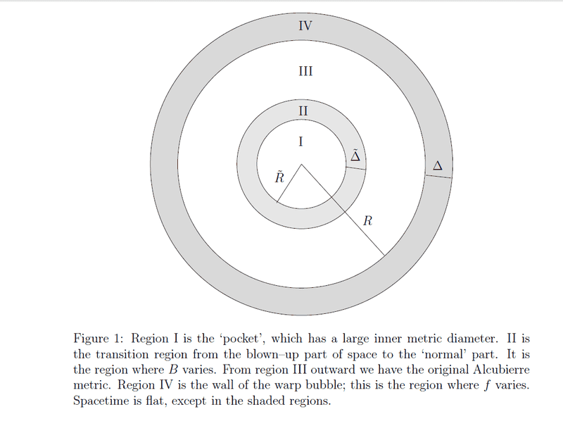

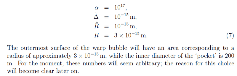

How to understand "The outermost surface of the warp bubble will have an area corresponding to a radius of approximately 3×10−15 m, while the inner diameter of the ‘pocket’ is 200m."??Something about higher dimensions?
Concentric ring diagram with regions I to IV: a central pocket I, transition ring II, region III, and outer wall IV, with radii R-tilde and R and widths Delta-tilde and Delta marked.
Typeset equations numbered (7): alpha = 10^17, Delta-bar = 10^-15 m, R-bar = 10^-15 m, R = 3 x 10^-15 m, followed by a paragraph about the warp bubble's outermost surface radius and the pocket's inner diameter.

So, why are you surprised? space is not Euclidean (by design).
From the article:
We will solve the problem of the large negative energy by keeping the surface area of the warp bubble itself microscopically small, while at the same time expanding the spatial volume inside the bubble.
So it's like a balloon with the hole for inflating it being the part that interfaces to our normal universe.

So you mean the expanding spatial volume has something to do with higher or extra dimensions ? And what is your favorite method of transportation?
