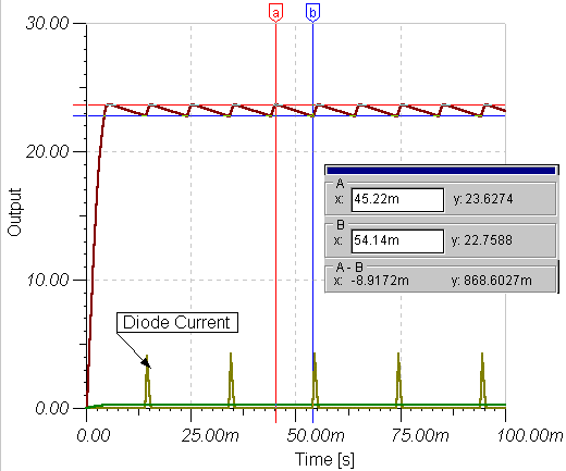

Your suggestion 3 would work only if the transformer and capacitor are preposterously oversized relative to the iron. Here's why.
Between line voltage peaks your capacitor will discharge ,
lowering the voltage,
as mfb stated.
Can you put a number on rate of discharge? Δv/Δt =i/C, volts amps and farads
Now, when next peak comes along and capacitor charges back up
instantaneous current is really high because you are moving charge only during the brief interval where incoming powerline sinewave is above capacitor voltage. ΔQ = iΔt .
Your iron draws charge out of your capacitor all the time
but your supply only replenishes charge during the brief interval surrounding sinewave peaks when Vincoming exceeds Vcapacitor.
So incoming current is not sine shaped but flows in short , large gulps .
those gulps of high current create more voltage drop in transformer windings than one would expect
so your cap won't get charged all the way to 1.414 Vincoming..
A drastically oversized transformer can however supply those high current peaks.
And an oversized capacitor can absorb the charge.
Here's an article explaining the phenomenon, just one of many from a google search
http://www.zen22142.zen.co.uk/Design/dcpsu.htm
observe short current bursts (I call them 'gulps' ). and compare their instantaneous to average value.
The poor little transformer is overloaded during those brief intervals and will drop quite a bit of voltage..
Simulated time-domain plot of output versus time in seconds, with a red trace rising then ripple near 23.6 and a green diode current trace showing periodic narrow current spikes labeled Diode Current; cursors a and b mark times 45.22m and 54.14m.
If you measure the DC resistance of your transformer windings you can estimate expected voltage at whatever current your iron draws.

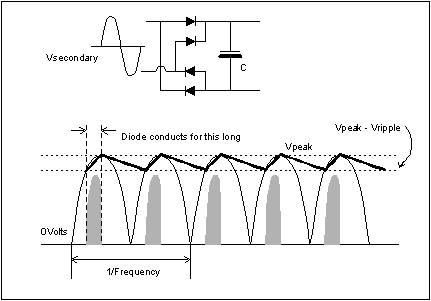

that's not quite so.
Here's a picture from another Google search , and it's worth a thousand words...
http://www.geofex.com/Article_Folders/Power-supplies/powersup.htm
Circuit schematic of a full-wave bridge rectifier with capacitor C, with a sine wave labelled Vsecondary, above a graph of rectified output showing peaks Vpeak, ripple Vpeak - Vripple, diode conduction intervals and 1/Frequency.
Heating value is RMS
With an oversize transformer, a rectifier and enough capacitance you can drive Vripple to near zero.
If ripple is small enough that voltage Vpeak-Vripple between peaks does not fall below .707 of Vsecondary 's peak, you have most certainly raised the RMS value of that odd voltage waveform. Draw a horizontal line at .707Vpeak and see...
But as always, one experiment is worth a thousand expert opinions. Try it and see.
old jim
