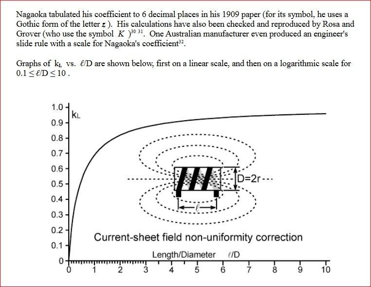

Re. #30 and #31 of Jim and NO : my understanding was that a solenoid had a uniform field inside and nearly all the flux passed through the ends, as shown on the hyperphysics solenoid page or
This would seem to suggest that if the secondary were wound on top of the centre portion of the primary (as shown in Ruby's photo), then all the flux (caused by primary current) would link both coils irrespective of the core or bifilar winding. (OTOH, perhaps not all of the flux due to any secondary current would link the primary, as the secondary is much shorter. But I (we?) haven't got that far yet.)
Re. #32 Jim, I agree with the nearly doubling of flux for any decent permeability core. The length of the air path is nearly halved and the air contributes nearly all the reluctance.
agreed. nearly all but there is leakage flux , integrate h dot dl around any single turn ?

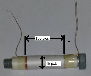

The concealed winding is the primary, I believe; it looks like it has been covered with a cardboard tube.
In OP's photo, the southern-most end of the primary seems like it's the beginning of clockwise wrapping (let's call it clockwise), but, unless my eyes deceive me, the upper end seems to emerge through the green tape after a counter-clockwise wrapping. So somewhere out of view, perhaps midway, the primary winding has deliberately been reversed?
Looks like Jim might be close to unravelling the Mystery of the Missing Volts! [emoji859][emoji361]
P.S. Jim, the 25 turn winding is denoted the secondary in OP's setup, but in your copy of the image you have labelled it Primary?
  • #37
Oh! I saw it oppositely. The green bits as start and end of the primary winding, with an extra bit of grey insulation in the middle. Then the secondary wound on top between the two yellow bits, about 1/4 the length of the primary.
If your interpretation is right, then two windings (either primary or secondary) accidentally connected antiphase would certainly explain zero output. (I see NO has already picked up on this as well.)

Sorry, I should be saying that OP "denoted" the 25 turn winding as the secondary. My count of the turns on the outer-most coil is 25, so I conclude it to be the secondary. (Editing my post now to replace "labelled" with "denoted".)
Are there four wires there or six? Am i mistaking shadows of wires for wires ?
Only 4 wire ends.

Well, I'm back in my play room. First result for my iron bolt transformer:
Primary winding: 100t ± , RP=1.7Ω ±0.1 Secondary 25t ± , RS= 0.2Ω ±0.2 (different wire)
I set it up with 0.506A AC 50Hz and measured a primary voltage of 0.96V and secondary voltage of 0.053V
The voltage across the resistance should be 0.86V , which, assuming only an inductive component at 90o, gives a voltage across the inductance of 0.43V.
The secondary voltage of 0.053V is a ratio of 1:8 rather than the ideal 1:4. I may well have miscounted the turns a bit, but I don't think I can have been that inaccurate. (I'm about to get winding again more carefully.) But there's enough output to measure - with a digital multimeter, but not my analogue meter. (Though whether even the digital multimeter is accurate at such low voltages, I wonder?)
I therefore doubt my claim that this setup would behave like a fully coupled transformer after allowing for the low inductance to resistance ratio.
Further, I notice that the flux in a solenoid does not increase with the number of turns in the primary (putting aside for the moment the idea that an ideal solenoid has an infinite number of turns!) The flux in a solenoid, either infinite (or sufficiently long to approximate that) is determined by the turns per unit length (and of course the current and μ.) So as you add turns, you would simply approach the ideal more closely.
So I guess that a transformer based on the form of a solenoid (surrounded by uniform permeability) might have a voltage ratio equal to the turns per unit length ratio. This would equal the turns ratio if they were wound the same length. But if the flux is uniform along the length of the solenoid, why would the secondary need to be spread out? Each secondary turn would link the same amount of primary flux wherever it was on the solenoid (well, best near the centre rather than near the ends.) So the secondary might best be pile wound at the centre? Then I'm back with no explanation for my 1:8 ratio.
Final worry! If I believe Hyperphys, adding a core to a solenoid multiplies the flux by k (or μ/μ0), rather than simply halving it as I had supposed. The permeability of the surroundings appears immaterial. Consistent with the notion that the solenoid generates no flux outside, but a bit puzzling for people who like flux lines to be closed loops. I console myself with the idea that space is very large, so there are very many paths for the external flux lines - effectively many parallel magnetic resistances, who's sum (edit: cross out "must" and substitute "might") approach 0.
But all this speculation is tiring my poor old brain. I'll go back to some more coil winding and experiments.

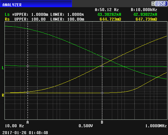

I used a slightly different bolt; mine is 3.5 inches long and .5 inches in diameter (instead of .3 inches). I used larger wire (26 AWG), and here's what it looks like with only the primary (100 turns) on. There is a layer of Nomex over the primary; that's what the white material is. I wound 25 turns over the nomex for a secondary:
Now I measured the parameters without the bolt (air core, in other words) using an impedance analyzer at 50 Hz. The imaginary component is on top with the real component below:
Then with the bolt in place:
The inductance with an "air core" was about 43 uH, and with the bolt in place it was 608 uH.
I used much larger wire than the OP, and the resistive part of my primary impedance is 3.5 times as large as the reactive part. For the OP the ratio is much larger.
A very telling thing I measured is the change in primary impedance when the secondary is shorted. In a "real" transformer, this will cause a large decrease in the primary impedance. For this bolt transformer, there was only about a 1.7% change. This means that the coupling between primary and secondary is very weak, so we shouldn't expect very much output on the secondary.
Most of the voltage applied to the OP's transformer is lost across the resistance of the wire. I wonder if the OP has a millivolt range on his DVM? :smile:

Jim, the impedance analyzer I'm using is this: http://www.waynekerrtest.com/global/html/products/LCR/6430%206440.htm
It makes a measurement by applying an AC voltage (or current) and measuring (4 terminals) the resulting current (or voltage) with a phase sensitive detector and thereby getting an in phase (real) and out of phase (reactive) value, then calculating things like impedance, admittance, Q, D, etc. I can also make a 4 terminal DC measurement.
Here's what I get for real part of the impedance (ohms) at several frequencies, with and without the bolt:
Code:
Frequency   Air core      Iron core
DC            .655         .655
50            .655         .706
1k            .655          1.522
10k           .658          4.865
100k          .852          14.61
We see that the AC resistance of the wire alone (air core) doesn't increase much (due to skin effect) with frequency until about 10 kHz, but with the iron in place, it increases rapidly.
I applied 1 VAC to the primary and with the bolt in place I measured .112 VAC on the secondary. Without the bolt (air core in other words), the output was .00646 VAC. I used the millivolt range on my DVM.

There's a pretty good derivation here for a long thin solenoid
he starts with Biot Savart, simplifies to a current sheet instead of individual turns
and comes to the familiar equation we all use which as Merlin said gives flux density as function of just mmf amp-turns per unit length,
http://info.ee.surrey.ac.uk/Workshop/advice/coils/air_coils.html
If b >> a (the solenoid is long and thin) then the angles ψ1 and ψ2 will both tend to zero for a point in the middle
B = μ0 Fl teslas Equation ACT (F1 he derives earlier as mmf amps/meter)
At the end of a long coil the flux will be exactly half this value. Only towards the ends does the flux 'leak' through the sides.
In a short coil considerable flux "leaks" out at both ends.
I haven't tried to calculate how much as a function of solenoid's length. I rely on my observations that inserting a core into my 12 foot coil just about doubled its flux. Its length do diameter ratio i'd estimate from memory around thirty-five.
length to diameter : 150/46 = 3.2 , if i understood .Ohhh the things they never mentioned in undergrad class ...
http://www.g3ynh.info/zdocs/magnetics/Solenoids.pdf page 32 of 97

I misspoke in post #53; the frequency of the measurement was 1000 Hz, not 50 Hz. Refer back to post #43 where the 50 Hz inductance with the bolt in place was 608 uH. At 50 Hz, the measured inductance is increased about 14 times by the insertion of the bolt.
You asked about the inductance as a function of frequency. Here's a sweep of the inductance and AC resistance measured at the primary (the 100 turn winding). The frequency is swept from 10 Hz to 1 MHz. The scale for the inductance curve (green) varies from 1 uH at the bottom of the image to 1000 uH at the top. The scale for AC resistance (real part of the impedance) curve (yellow) varies from .1 ohm at the bottom to 100 ohms at the top. There are two markers, A and B. The values of inductance and resistance at the marker frequencies (50 Hz and 10 kHz) can be read at the top right of the image. This sweep is for the coil without the bolt inserted ("air" core, in other words):
Notice how the inductance is constant with frequency and the resistance is constant until it begins to rise in the neighborhood of 50 kHz due to skin and proximity effect.
Now with the bolt inserted:
We see inductance decreasing drastically with increasing frequency, and resistance increasing.
Here are both sweep results superimposed:
Notice how the inductance with the bolt inserted actually becomes less than the "air" core value as the frequency increases above about 45 kHz. At such high frequencies, the bolt just looks a shorted turn with very little penetration of flux into the bolt.
