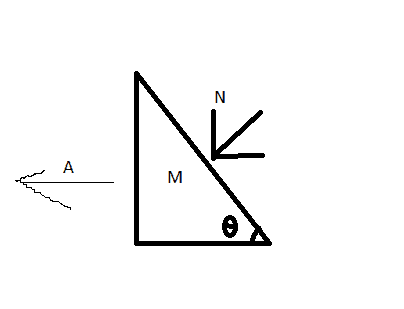

see attached image
F=ma
I have the relations
1)M.asinθ=N
2)N.sinθ=Ma
Which one is correct and why?
3)if (1) is incorrect is the correct relation --M.asinθ+M.gcosθ=N?
  • Free-body diagram of a wedge of mass M with a right angle at the bottom left and angle θ at the bottom right, with an arrow A pointing left at the vertical face, and a normal force N arrow pointing down-left perpendicular to the sloped face.
Forces and accelerations are vectors. Once you have Newton's second law in the vector form, you obtain equations for the components of forces and accelerations. In this case, you only care about the horizontal components. What are they?
of acc. are-- a and (nsinθ)/m
and force are-- ma and nsinθ
but my main question is that is my equation 3 correct?

It is not that "a and (nsinθ)/m" are "acceleration components". a = (nsinθ)/m is the horizontal acceleration component.
I do not see any "g" in the picture so based solely on the picture, that equation is definitely wrong.

I have taken g to be the acceleration downwards due to gravity
Perhaps you need to describe your problem in full detail. What you have now makes little sense.

from here i have got the relations
1)N=M.g.cosθ+M.a.sinθ
2) a.cosθ=g.sinθ
Edit:i have forgotten to consider the normal force from underneath , I'm going to re-write the equations
Edit: nevermind these equations are totally useless

As are the diagrams. Please state the question exactly as it was given to you.
I wasnt having any actual problem in solving questions it was just that i wanted to check whether or not i could derive relations by using different x-y directions, but the new general equations turned out to be useless.
