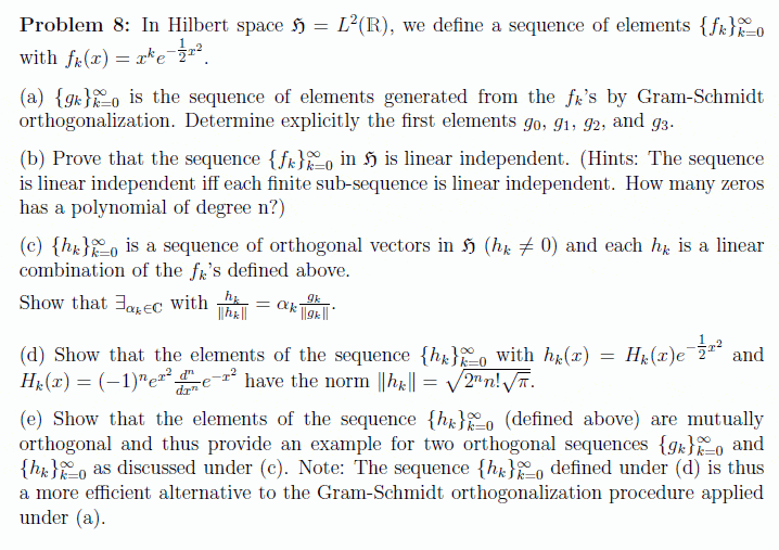

Show that the elements of the seqeunce [tex]h_k\left(x\right)=H_k\left(x\right)e^{-\frac{1}{2}x^2}[/tex] and [tex]H_k\left(x\right)=\left(-1\right)^n e^{x^2}\frac{d^n}{dx^n}e^{-x^2}[/tex] have the norm [tex]||h_k||=\sqrt{2^nn!\sqrt{\pi}}[/tex]
[tex]||h_k||=\sqrt{\left(h_k^*,h_k\right)}[/tex]
[tex]\left(h_k^*,h_k\right)=\int{h_k^*h_kdx}[/tex]
[tex]h_k\left(x\right)=\left(-1\right)^n e^{x^2}e^{-\frac{1}{2}x^2}\frac{d^n}{dx^n}e^{-x^2}=\left(-1\right)^n e^{\frac{1}{2}x^2}\frac{d^n}{dx^n}e^{-x^2}[/tex][tex]||h_k||=\sqrt{\int{\left(\left(-1\right)^n e^{\frac{1}{2}x^2}\frac{d^n}{dx^n}e^{-x^2}\right)^*\left(\left(-1\right)^n e^{\frac{1}{2}x^2}\frac{d^n}{dx^n}e^{-x^2}\right)dx}}[/tex]
[tex]=\sqrt{\int{\left(e^{x^2}\frac{d^{2n}}{dx^{2n}}e^{-2x^2}\right)dx}}[/tex]
I tried using [tex]\int{udv}=uv-\int{vdu}[/tex]
[tex]u=e^{x^2}[/tex]
[tex]du=2xe^{x^2}dx[/tex]
[tex]dv=\frac{d^{2n}}{dx^{2n}}e^{-2x^2}dx[/tex]
[tex]v=\frac{d^{2n}}{dx^{2n-1}}e^{-2x^2}[/tex] I don't think that's right.
Any help would be appreciated.
The interval that seems to work goes from 0 to infinity.
First, surely you mean :
[tex]H_k\left(x\right)=\left(-1\right)^k e^{x^2}\frac{d^k}{dx^k}e^{-x^2}[/tex]
and
[tex]||h_k||=\sqrt{2^k k!\sqrt{\pi}}[/tex]
right? :confused:

Here is an image of the problem statement -- part (d):
Can you post your image to imageshack.us instead? (Attachments cannot be viewed by other posters until they are approved by admin----which often takes a while)
I guess that is a typo on the instructor's part.

gabbagabbahey said:
[tex]h_k^*h_k=e^{x^2}\left(\frac{d^k}{dx^k}e^{-x^2}\right)^2\neq e^{x^2}\left(\frac{d^{2k}}{dx^{2k}}e^{-2x^2}\right)[/tex]
Well then, if you don't mind me asking, what is it?
Try using
[tex]u=e^{x^2}\left(\frac{d^k}{dx^k}e^{-x^2}\right)[/tex]
and
[tex]dv=\left(\frac{d^k}{dx^k}e^{-x^2}\right)dx=\frac{d}{dx}\left(\frac{d^{k-1}}{dx^{k-1}}e^{-x^2}\right)dx[/tex]
to integrate by parts.

Okay, now use the fact that
[tex]\left(\frac{d^n}{dx^n}e^ {-x^2}\right)=\frac{d^{n-1}}{dx^{n-1}}\left(\frac{d}{dx}e^ {-x^2}\right)=\frac{d^{n-1}}{dx^{n-1}}\left(-2xe^ {-x^2}\right)[/tex]
and
[tex]\left(\frac{d^{n+1}}{dx^{n+1}}e^ {-x^2}\right)=\frac{d^{n-1}}{dx^{n-1}}\left(\frac{d^2}{dx^2}e^ {-x^2}\right)[/tex]
to simplify
[tex]\left[2xe^{x^2}\left(\frac{d^n}{dx^n}e^ {-x^2}\right)+e^{x^2}\left(\frac{d^{n+1}}{dx^{n+1}}e ^{-x^2}\right)\right][/tex]
[tex] e^{x^2}\left(\frac{d^n}{dx^n}e^{-x^2}\right)\left(\frac{d^{n-1}}{dx^{n-1}}e^{-x^2}\right)-\int{\left(\frac{d^{n-1}}{dx^{n-1}}e^{-x^2}\right)\left(2xe^{x^2}\left(\frac{d^n}{dx^n}e^ {-x^2}\right)+e^{x^2}\left(\frac{d^{n+1}}{dx^{n+1}}e ^{-x^2}\right)\right)dx}[/tex]
[tex] =e^{x^2}\left(\frac{d^n}{dx^n}e^{-x^2}\right)\left(\frac{d^{n-1}}{dx^{n-1}}e^{-x^2}\right)-\int{\left(\frac{d^{n-1}}{dx^{n-1}}e^{-x^2}\right)\left(2xe^{x^2}\left(\frac{d^{n-1}}{dx^{n-1}}\left(-2xe^ {-x^2}\right)\right)+e^{x^2}\left(\frac{d^{n-1}}{dx^{n-1}}\left(\frac{d^2}{dx^2}e^ {-x^2}\right)\right)\right)dx}[/tex]
Not seeing how this can be simplified much.
Calculate [itex]\frac{d^2}{dx^2}e^{-x^2}[/itex] explicitly and then simplify...
Also, don't forget your integration limits!

Actually, instead if using the advice of post #18, just use the Leibniz rule to simplify
[tex]\left(\frac{d^{n+1}}{dx^{n+1}}e^ {-x^2}\right)=\frac{d^{n}}{dx^{n}}\left(-2xe^ {-x^2}\right)[/tex]
it's much quicker this way!
I see that the uv term goes away, as I suspected.
So I'm left with:
[tex] ||h_n(x)||=-\int_{-\infty}^{\infty}{\left(\frac{d^{n-1}}{dx^{n-1}}e^{-x^2}\right)\left(2xe^{x^2}\frac{d^{n}}{dx^{n}}e^{-x^2}+e^{x^2}\frac{d^{n+1}}{dx^{n+1}}\\e^{-x^2}\right)dx}[/tex]
Now I can see that the first term is a polynomial times [itex]e^{-x^2}[/itex]
And the second term is too, but the [itex]e^{x^2}[/itex] cancels it out. And the same with the last term.
So I only have one [itex]e^{-x^2}[/itex] in the integral, which accounts for the [itex]\sqrt{\pi}[/itex] in the answer I'm looking for.
I can see that every time you differentiate [itex]e^{-x^2}[/itex] you'll get a factor of [itex]-2x[/itex].
So that's where the [itex]2^n[/itex] comes from.
But I'm not seeing where the [tex]n![/tex] comes from.
And what happens to the rest of the terms in the polynomials? Why is [itex]2^n[/itex] the only thing that survives?

The first one is [tex]-2x[/tex].
The second: [tex]4x^2-2[/tex]
The third: [tex]-8x^3+...[/tex]
I figured them out for 7 iterations, looking for a pattern so I could write in in the form of a sum. But I couldn't figure it out. I did notice that the first term is always [tex](-2)^n[/tex], and each power of x is either odd or even.
Would you happen to know what that polynomial is in terms of n? If I can figure out how to write it as a sum, I may be able to work with it.
Use the Leibniz rule you posted earlier! You'll be pleasantly surprised with the result.
[tex]\frac{d^n}{dx^n}(-2xe^{-x^2})=\sum_{k=0}^n{\frac{n!}{k!\left( n-k\right)!}\frac{d^k}{dx^k}(-2x)\frac{d^{n-k}}{dx^{n-k}}(e^{-x^2})[/tex]
How many times can you take the derivative of (-2x) before you get zero?:wink:
