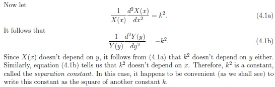

How did you get the two equations above?
Instead of a messy attempt at typing it out, here's a screen grab of my lecture notes which show the exact process I used:
As far as I can tell, my method seems to be ok but I'm stumbling on the boundary conditions.
I've had a look at some other notes provided by the lecturer and at a guess I'd say my problem is that I need to find a way to lose the x-dependent and y-dependent terms when I work through the boundary conditions.

I see that your notes say:
What is it that makes this convenient?
It seems to me that your choice of using the negative separation constant with Y rather than with X commits Y to being sinusoidal and X to be exponential.
Unless I'm misreading them, the boundary conditions suggest just the opposite assignment.
View attachment 96290 .
I've just run it through with the differential equation's signs alternated as you suggested, and it still comes out with an almost identical dead end.
Only difference is I get an imaginary term. In my first attempt I get as far as:

Found the answer
T(x,y) = T0 + [T1/cos(π/2)] [sin(πx/L)cosh(πy/L)]
Thanks!
sa1988 said:
Found the answer
Thanks!
Do you have a typo there?
Ha, yes indeed I do.
T(x,y) = T0 + [T1/cosh(π/2)] [sin(πx/L)cosh(πy/L)]
