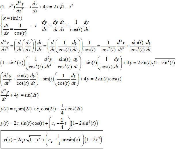

Hi !
I suggest to bring back your result y(x) into the ODE. So that, you will check if your result is correct or not.
This is what I obtained :
Welcome on MHB JJaquelin!... after Your post I verified some mistakes in my calculation and I corrected them... anyway that is probably not jet all right and further controls of me are necessary... Kind regards $\chi$ $\sigma$
