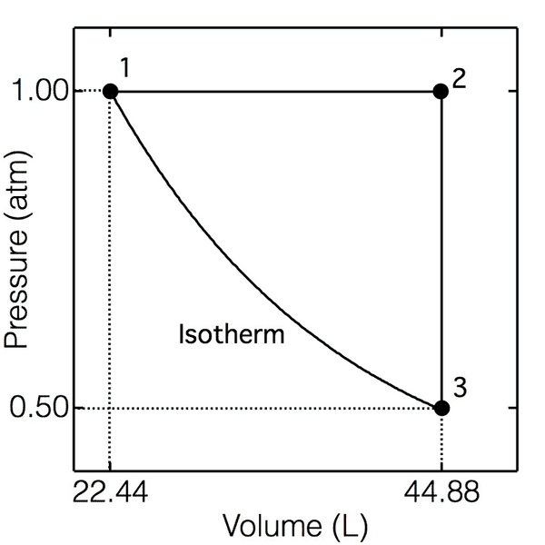

6) A sample consisting of 1.00 mol of a monatomic perfect gas (for which CV,m = 3/2R) is taken
through the cycle shown below. (a) Determine the temperatures at 1, 2, and 3; (b) Calculate q, w,
ΔU, and ΔH for each step and the overall cycle. If a numerical answer cannot be obtained, then
write +, -, or ? as appropriate.

6) A sample consisting of 1.00 mol of a monatomic perfect gas (for which CV,m = 3/2R) is taken through the cycle shown below. (a) Determine the temperatures at 1, 2, and 3; (b) Calculate q, w, ΔU, and ΔH for each step and the overall cycle. If a numerical answer cannot be obtained, then write +, -, or ? as appropriate.
