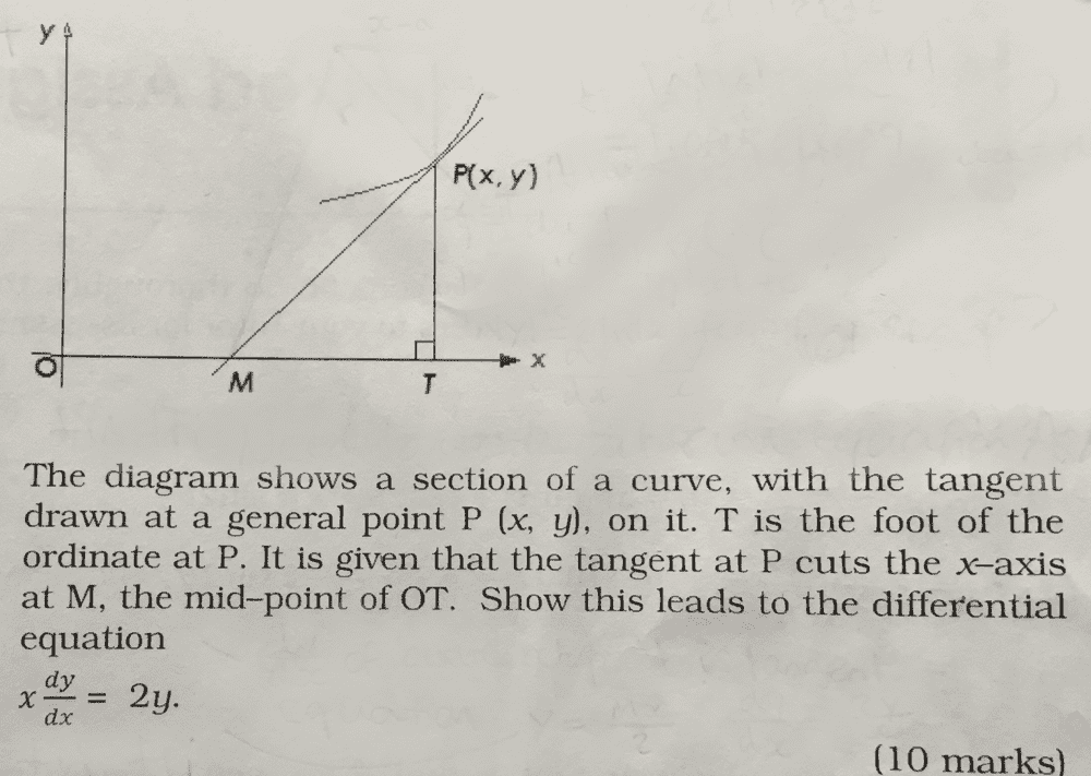

Hi,
I have included an attachment of the question about differential equations. I found a similar question and solution on this website:
https://doubtnut.com/question-answer/a-tangent-at-a-point-p-on-the-curve-cuts-the-x-axis-at-a-and-b-is-the-foot-of-perpendicular-from-p-o-262330
Given differential equation:
xdy/dx = 2y
Here is my attempt at a solution:
y = f(x)
yp - ym = dy/dx(xp-xm)
ym = 0
yp = dy/dx(xp-xm)
xm=ypdy/dx + xm
xm is midpoint of OT
xm = (ypdy/dx + xm) /2
Not sure where to go from there because the solution from the link uses with the midpoint of the points A and B intersecting the x-axis, whereas the assignment question concerns the points M and T on the x-axis, where M is the midpoint between the origin and T. Can anybody give any clues?

Hello, @so_gr_lo .
:welcome:
Notice that xp = 2 xm .
Also, xp and yp are the same as x and y, the coordinates of the general point, P .
I have no idea of what the statement regarding points A and B could possibly mean.

As @SammyS pointed out, you don't need subscripted variables, and the hint given by @STEMucator is much more complicated than is needed. You don't really need either the point-slope form of a line or the midpoint formula.
The proof can be done in two lines, if you assign coordinates to points T and M, and recognize that the derivative dydx gives the slope of the tangent line.

So I think this is the way to do it:
y - yM = dy/dx(x - xM)
yM = 0
y = dy/dx(x - xM)
xM = 1/2x
y = dy/dx(1/2x)
xdy/dx = 2y
Thanks for the help, since the question had 10 marks I assumed the answer was complicated and got confused by the solution in the link.
Or more simply, the gradient of the tangent line is ##\frac{dy}{dx}##, and that equals the rise over run of that triangle, ##\frac{y}{\frac{x}{2}}##. Namely, ##\frac{dy}{dx} = \frac{2y}{x}##.
yM = 0
y = dy/dx(x - xM)
xM = 1/2x
y = dy/dx(1/2x)
I know what you mean, but that's not what you wrote.
1/2x means ##\frac 1 2 x##, because multiplication and division have the same precedence, and are grouped from left to right. That means that 1/2x is considered to mean (1/2)x, not 1/(2x) as you intended.
To indicate that 2x is in the denominator in both equations above, use parentheses around 2x, like this:
xM = 1/(2x)
y = dy/dx(1/(2x))
