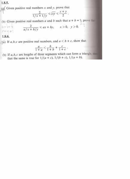

Is what I wrote on the left hand margin a counterexample to 1.8.5 part a) ?
EDIT: I meant part b)
And changing a+b=1 to a+b=2 makes the inequality correct, right?
Also, in part b) of 1.8.7, are they asking me to show that 1/(a+c) < 1/(b+c) + 1/(a+b) ?
At a+b=2, you will not see the equality. There's a lower value of a+b that will realize this.
I think not (it's poorly written).
I think they want you to show : 1/(b+c) < 1/(a+c) + 1/(a+b)
How is that different? The problem is symmetric in a,b,and c; they are just the lengths of the three sides of a triangle.
What should the problem be then?
Doh! Right - I can't remember what I was thinking.
Several possibilities. For one, a+b=\sqrt{2}, everything else unchanged.
For 1.8.5, with Gokul's correction, I still don't see how to prove it. I find that the inequality is equivalent to:
[tex]2 \leq a^2+b^2+ab(y/x +x/y)[/tex]
y/x+x/y is greater than or equal to 2, but I do not see how that helps.
For 1.8.6, I found that the inequality is equivalent to:
[tex]b^2 < a^2 + b(a+c)+ac+c^2[/tex]
which I am not sure how to prove.
