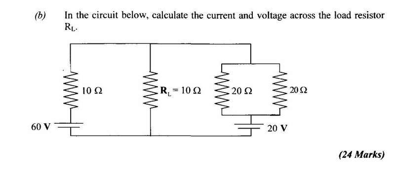

Hello there, hope you are well.
I am having trouble solving this problem involving Kirchoff's laws.
I have attached a copy of the circuit and problem to this post in jpeg format.
Thanks again in advance for any help.
Mike
Well I merged to the two 20 ohms into one 10ohm and said that the total voltage in any loop equals zero.
so 60=20Ia + 10Ib
and 20=20Ib + 10Ia
I have tried solving this many times and keep getting a negative current for Ib. My original equation must be wrong.
Thanks a lot for any help or input,
Mike

Hi Mike! :smile:
physicsfun_12 said:
… 60=20Ia + 10Ib
and 20=20Ib + 10Ia
Which loop has Ia, and which has Ib, and in which direction? :confused:
And what about Ic ?
(and where do those 20s on the RHS come from?)
I think I've got it now.
I was using loop analysis so that's why there is only two currents.
The 20s came from 60=10Ia + 10(Ia+Ib) which expands to give 20Ia + 10Ib
You can work out the currents using simultaneous equations, giving a Ia=3.333A and Ib=-0.6666A
I of the load resistor, Il=Ia+Ib = 2.6667A
So Vl=2.6667*10 = 26.667V
Does this look about right? Thanks a lot for your help
Mike
ohhh! you should always state an intermediate step like that :rolleyes:
(apart from anything else, you stand a good chance of making a mistake with ±s if you don't write this stuff out clearly)
Yes, the answer looks ok now. :smile:
Sorry about that, you are absolutely right... that's most probably why I was getting it wrong in the first place!
Thanks for your help and take care,
Mike
