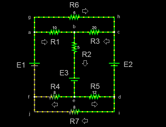

We were given a circuit with 7 resistors and 3 voltage sources
For emf sources, ##E_1=120V##, ##E_2=60V##, and ##E_3=30V## while for resistors in ohms,##R_1=10##, ##R_2=5##, ##R_3=20##, ##R_4=8##, ##R_5=12##, ##R_6=6##, ##R_7=8##. Nodes are indicated in small letters (a-j). Loops ##abefa##, ##abcdefa## and ##aghcdijfa## are assumed clockwise while the loop ##cbedc## is counterclockwise.
I applied Kirchoff's Current Rule in nodes ##b## and ##e##:
I_1+I_3 = I_2\\
I_4+I_5 = I_2
And then I apply the Voltage Rule:
Loop ##abefa##:
$$120-I_1R_1-I_2R_2-30-I_4R_4=0$$
Loop ##cbedc##:
$$60-I_3R_3-I_2R_2-30-I_5R_5=0$$
Loop ##abcdefa:##
$$120-I_1R_1+I_3R_3-60+I_5R_5-I_4R_4=0$$
Since I have 5 equations already with 5 unknows, hopefully I should solve these values.
From 1st and 2nd equations, ##I_4 = I_2-I_5 = I_1+I_3-I_5##. Setting ##I_4##, and ##I_2## in terms of ##I_1##, ##I_3## and ##I_5## only and substituting them to equations 3, 4 and 5, I get:
23I_1+13I_3-8I_5=90\\
18I_1-12I_3-20I_5=60\\
5I_1+25I_3+12I_5=30
Luckily my calculator supports systems of equations for 3 uknowns, but then I get a math error, which could indicate infinitely many solutions? Maybe I incorrectly applied Kirchoff's rule but I don't know where. Is it valid to apply Kirchoff's rule here?

The determinant of the matrix is very small, 7.7793e-13, so your guess of multiple solutions may be essentially correct. That may mean that you have overlooked an independent equation. I don't see one.
The abcdefa loop is just a combination of the other 2 loops, so you only have 2 equations with 3 unknowns. None of the loops involves R6 or R7 or the currents through them. I think you should end up with 4 equations and 4 unknowns

Good catch. The loop aghcdijfa was listed but forgotten.

There are 7 unknown currents and 7 equations
3 loops:
aghcdijfa,abefa,cbedc
4 current enterings points:
b,f and a,d and c, and e
