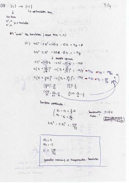

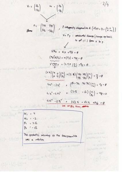

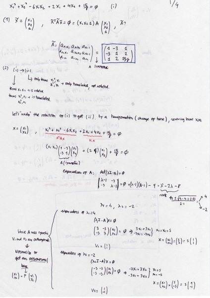

Hello again,
Sorry about the late reply. Have been quite busy with other work.
After learning the properties of symmetric matrices and eigenvalues/vectors, I think I could solve most of the problem. But have doubts in the last parts of the problem. My main doubt now is how could I express the translation of section (3) as a matrix to be used in (4) for the composite transformation...
I uploaded 4 scanned pages of what I have done so far:
http://i50.tinypic.com/zsvlmg.jpg"
http://i49.tinypic.com/1zyydkh.jpg"
http://i45.tinypic.com/2mynbqb.jpg"
http://i47.tinypic.com/bjipmc.jpg"
I would be very grateful if someone could check it...
Thanks in advance...
Could some please check if this is ok, specially parts 3-5?
Thanks
Page 1 : sections (1) and (2) of the problem
Handwritten linear algebra working on a quadric equation x1^2 + x2^2 - 6x1x2 + 2x1 + 4x2 + 15/8 = 0, with a symmetric matrix A, its eigenvalues 4 and -2, eigenvectors, and an orthogonal change of basis.
Page 2 : section (2) (cont)
Handwritten linear algebra working, page 2 of 4: eigenvectors v1 and v2, orthogonal matrix P, substitution x = Py, and the resulting quadratic form 4y1^2 - 2y2^2 + 3√2 y1 - √2 y2 + 15/r = 0, with eigenvalues λ1 = 4, λ2 = -2, β1 = 3√2, β2 = -√2 in a box below.
Page 3 : section (3)
Handwritten working for a quadric transformation, labelled (3) (ii) to (iii), with a boxed result listing coefficients alpha1 = 4, alpha2 = -2, and C = 109/32.

Handwritten working on lined paper: a matrix equation with a diagonal matrix containing 4, -2 and 109/32 is given, and the conic 4z1^2 - 2z2^2 = 109/32 is divided by 109/32 to give a hyperbola, with a small sketch of the hyperbola at right.
  • Handwritten linear algebra working for a quadratic form: the equation x1^2 + x2^2 - 6x1x2 + 2x1 + 4x2 + 15/8 = 0, a symmetric matrix A with eigenvalues 4 and -2, and eigenvector calculations.

  • Handwritten linear algebra working, page 2 of 4: eigenvector columns, orthogonal matrix P, substitution x = Py giving 4y1^2 - 2y2^2 + 3√2 y1 - √2 y2 + 15/f = 0, and a boxed list of coefficients.

  • Handwritten working for part (3) of a quadric-classification problem, showing completing the square on 4y1^2 - 2y2^2 + 3√2 y1 - √2 y2 + 15/4 = 0 and a coordinate translation with boxed coefficients α1 = 4, α2 = -2, C = 109/32.
