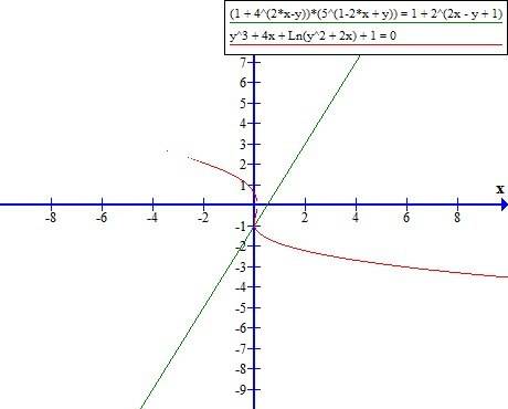

I do have a very suggestive graph however, which should give an idea about how to prove it. (I zoomed out to some really high values and that green function just keeps looking like it's a straight line.)
-Dan
