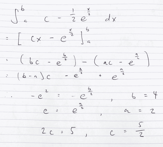

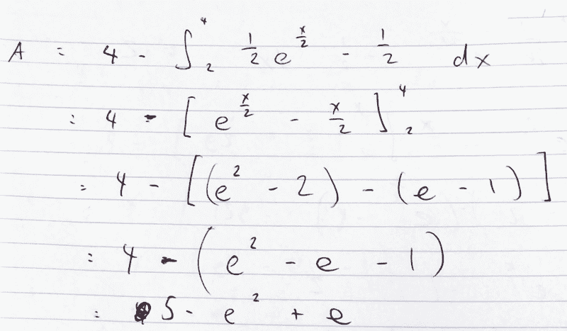

To solve the below problem, I assumed the affected area was 2x2 minus the definite integral of the given function between 2 and 4.
I then equated the answer for that with the given function to solve for a, b and c.

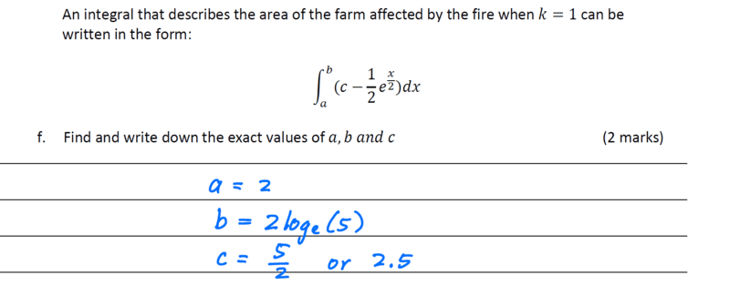

I don't know why the solutions give b as 2ln5.
Have I made a mistake, or are the solutions wrong?

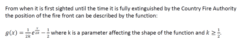

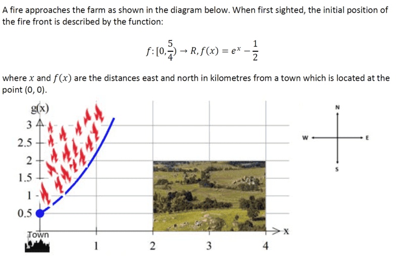

You are trying to work out a, b and c by solving equations. That cannot work, as you have three unknowns and only one equation. Instead you set the values a and b from first principles, as the lower and upper bounds of x at which the fire front intersects the farm. Given the fire front equation is ##f(x) = \frac12 e^{\frac x2}-\frac12## and the farm is ##[2,4]\times [0,2]## we see that the intersection points are ##(2,e^\frac12)## and ##(b,2)##, the second point being where the fire front intersects the line ##y=2##. That second point gives us the equation
$$2 = f(b)=\frac12 e^\frac b2-\frac12$$
which we solve to get
$$b=2\log 5$$
Now that you know ##a## and ##b## you can solve the equation to find ##c##.

I also think that the "4=(4-2)x(2-0)" in your equation for A shouldn't be 4 but instead ##(b-2)\times(2-0)=2(b-2)##, hard to explain with words without making a scheme (I am really bad in making schemes).
Yeah, I drew the diagram for myself wrong. I assumed the fire front would touch the right edge of the property (which it didn't).
