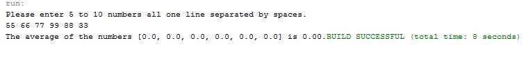

I want to alter my program so it can take an unknown amount of elements (user inputs). I want the program to automatically count the numbers the user is inputting up until they hit enter to the next line. I think I got the program to keep track of this but now my output is a bunch of zeros in place of the user numbers. I don't know how to fill the array with the user numbers as well as keep track of the array size. I have attached a screenshot of the output.
Please let me know if I've been unclear. Any help, direction or hints will be greatly appreciated. I feel like I'm really close to solving this.
on Phys.org
Never mind, I figured it out. It doesn't stop between 5 and 10 inputs but as long as the user follows the prompt it should be okay.
