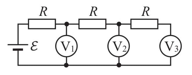

Three equal resistors and three equal voltmeters are connected as shown. V1 shows 10V and V3 shows 8V. Find V2.
Ohm's Law
I don't know how to solve it since the voltmeters are connected in parallel. Shouldn't they show the same?

If the voltmeters shown were ideal (infinite impedance) then there would be no complete path (circuit) for current to flow, thus no potential drops could occur across the resistors and they'd all show the same reading. But we are told that there are potential drops since the two given voltage readings are different. Does that suggest anything to you?
Nope. Are you saying that voltmeters have their own resistance?
Yes. They must if there's current flowing. The only path back to the source E is via voltmeters.
So should I use Kirchhoff's rule or what? Please help, I am new to all of this.
Well you'll surely need Kirchhoff simply to write circuit equations. I can't think of a standard approach for this problem since simply writing node or loop equations will leave you with too many unknowns. That leaves being clever and getting creative :smile:
My suggestion would be to reduce the number of unknowns by either combining them or making them irrelevant. How does one do that, you ask? Well for starters you've got only two resistor values (Let's call the voltmeter resistance r) in the circuit, and something tells me from the repeating blocks (Resistor + Voltmeter sections) that maybe the ratio of the r to R could be important. So make r = n*R.
Next, the source E is an unknown. Let's get rid of it! Chop it off along with the first R and replace the first voltmeter with a 10V source. Note that this won't affect the rest of the circuit to the right of it! v1 is now fixed at 10V just as before and the "load" on it is the same.
See if you can then write a node equations to solve for v2, keeping an eye out for maybe eliminating either R or n along the way. Remember that you have the voltage at the output of the voltage divider formed by v2 and resistors R and nR (a voltmeter).

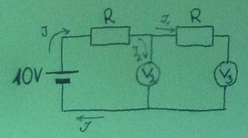

Here's what I did:
r - resistance of the voltmeter
Obviously, I can't solve it using Kirchhoff's rule.

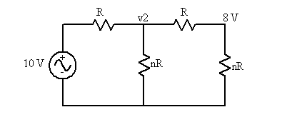

Here's the "reduced" circuit:
Ignore the 8V for now: You can use it later to form another equation. Write the node equation, treating the right branch as R + nR. Note that the current through the leftmost resistor is NOT 10/R. It's (10 - v2)/R if you choose to sum currents flowing into the node, or (v2 - 10)/R if you choose to sum currents flowing out of the node. You need to use potential differences across each resistor.

How about this:
## \frac{10}{R}-\frac{V_2}{nR}-\frac{V_2}{(R+nR)}=0 ##
kaspis245 said:
How about this:
Getting closer!
If you explain in words what each term represents, you'll probably realize your mistake.
Is this correct:
## \frac{10-V_2}{R}-\frac{V_2}{nR}-\frac{V_2}{(R+nR)}=0 ##
kaspis245 said:
Is this correct:
That looks right. :smile:
I get this:
## V_2= \frac{10n+10n^2}{1+n+n^2} ##
I don't see how this would help me.
