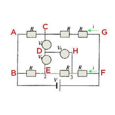

In the circuit shown below, all three voltmeters are ideal and identical. Each resistor has the same given resistance R. Voltage V is also given. Find the reading of each voltmeter.
i = 2V/3R
Applying Kirchhoff's Law to BACDE
V1+V2=0
Loop CDHFG
V1+V3=2V/3
Loop DEH
V2+V3=2V/3
Solving these three, I get incorrect answers.

You've calculated I incorrectly. Since the voltage V appears across 3 R's in series, I = V/(3R).
Oops! I used incorrect notation for current. The current in the circuit as a whole is 2V/3R. The currrents in individual branches are V/3R.
Correct. Does this solve your original problem?
No. The correct answers are V1=V2=V/9 and V3=2V/9
If you've posted the problem correctly, I don't think that can be the correct answer. VC = VE = V/3, so V1 and V2 should both read 0 and V3 should read V/3.
