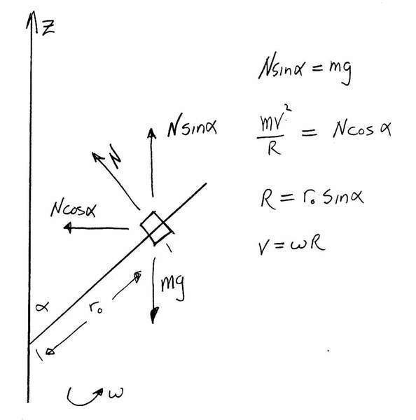

There is a rod rotating around the z axis with angular velocity [itex]\omega[/itex].The angle between the rod and z axis is constant and equal to [itex]\alpha[/itex].A mass m is constrained to move on the rod.The gravitational force is in the negative direction of z axis and the friction between the mass and rod is negligible.At time t=0 , the mass is at distance [itex]r_{0}[/itex] from the origin and is stationary relative to rod.
1-In a proper coordinate system,write the Newton's second law for the mass in a inertial frame of reference and write the differential equations of motion.Highlight the expressions indicating the reaction of rod.
2-Solve the differential equations and write the mass's distance from origin as a function of time.
3-Calculate the reaction force of the rod(direction and magnitude)
thanks
Does the following get you started?
Thanks a lot.My mistake was that I didn't write N but only the centripetal force.
But it seems sth is wrong there.Just imagine such a thing not rotating.you know that the mass slides down.So it seems that [itex]N \sin {\alpha}[/itex] is not equal to mg.

Do you know what i said?
