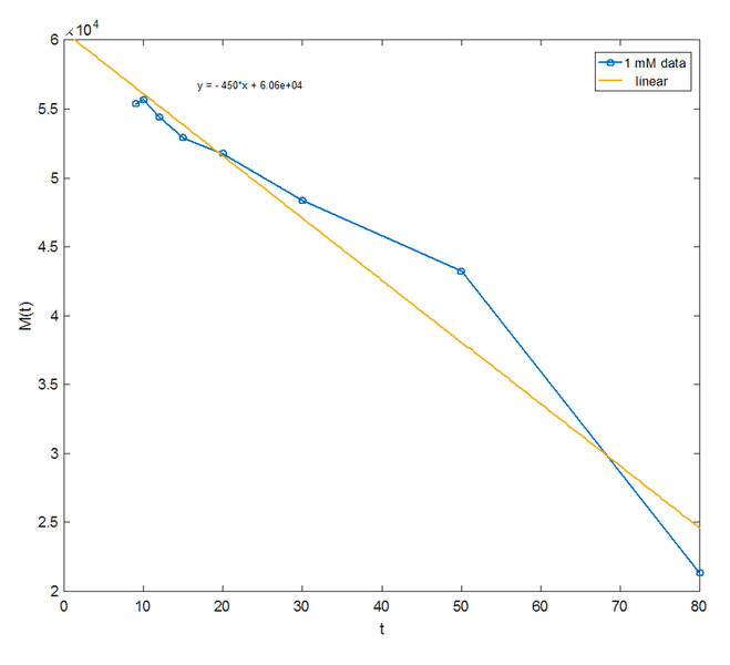

Using experimental data, I am trying to solve the following equation for ##T_2##
$$M(t)=M_0 e^{-t/T_2}. \tag{1}$$
Here ##M_0## denotes the initial value. There were 8 data points collected for ##t## and ##M(t).## Here is the resulting graph:
Plot of M(t) against t with data points joined by a blue line, falling from about 55000 at t=9 to about 21000 at t=80, with a straight orange linear fit y = -450x + 6.06e+04 overlaid.
The data and equation (1) in fact relate to MRI experiments. I am attempting to calculate ##T_2## relaxation time of a given solution. (##t## is in ms and ##M(t)## in arbitrary units)
I have fitted the data with a linear fitting. So, what part of equation (1) does the slope of the plot correspond to? This is not obvious because the plot is exponential rather than linear. :confused:
My approach was to somehow equate the slope to some part of equation (1) containing ##T_2##, so I can then solve for it. How could I do that?
Any help would be greatly appreciated.

If you are trying to fit an exponential function you should use an exponential function fit, not a linear one.

It's not at all clear to me what you are trying to do. What is the value of ##M_0##?
If you are looking for an exponetial solution, what is the point of finding a linear solution?
The data, at first sight, does not seem to fit well with any exponential solution.
This is indeed also true. However, the measurements we are presented with do not have error bars, so we cannot really say anything about the goodness of the fit.

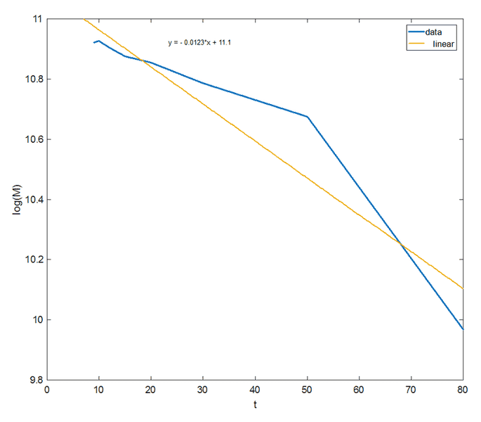

Thank you for your input. When I plot log(M) vs. t , I get a good estimate of ##T_2## and ##M_0## (but not as accurate as the exponential model).
And the log graph is not completely linear in t. It has the same overall shape as the original function I've posted above. Why is that?
Line graph of log(M) against t from t=0 to 80, with a blue data curve and an orange straight-line fit labelled y = -0.0123*x + 11.1; the data curve bends, steeper after about t=50.
Like the previous posters mentioned, this data does not appear to be exponential, since linear is a better fit overall. However, if you have to fit it to the model you provided, then fitting the log is one easy way to do it.
In this case, what do you get for M0 and T2?

Apparently, the line labelled "linear" on the plot is really logM vs t, which, for an exponential, would appear linear on the plot if the data was consistent with the equation. There seems to be only one data point "out of whack" on the plot, and this data point should be checked more carefully.

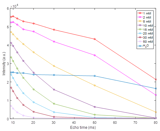

Thank you for your comments. Yes, the last point should have a slightly higher intensity in order for the curve to be exponential.
Also, I believe the final value of M is about zero, because when we have saturation, there is no net magnetisation and hence no NMR signal.
I have labeled the units of time on the diagram. In fact, I made several plots for data corresponding to different substances. for more concentrated cases they appear to be more exponential (the data I was trying to fit above is the red line in the graph below). If I use an exponential fitting for the 15 mM case, the R2 value would be 1.

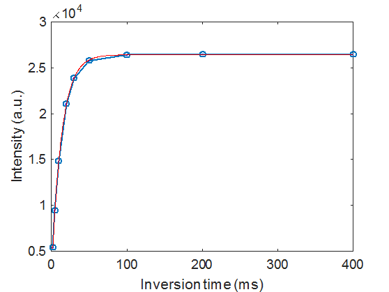

I have a related question. If instead of an exponential decay, we had an exponential growth given by
$$M_z (t)=M_z(0) e^{-t/T_1} + M_0 (1-e^{-t/T_1}) \tag{2}$$
Graph of Mz(t) against Time: a curve starting at Mz(0) near the bottom and rising steeply, then levelling off asymptotically toward the dashed horizontal line labelled M0 at the top.
And I had measurements of ##M_z (t)## over a range of ##t,## what would be a good fitting to work out ##T_1##?
The following is a fitting two-term exponential model I made for my data:
Plot of Intensity (a.u.) against Inversion time (ms), with blue data points joined by a line and a red fitted curve, rising steeply from about 5000 near 0 ms and levelling off at about 26500 by 100 ms.
It has the following equation
$$26420 e^{(1.347\times 10^{-6})x} -24500 e^{(-0.07508)x}.$$
Since the two exponents are very different, how would I work out ##T_1##? I would get two very different values. :confused:
And if I plot ##log (M_z (t))## vs ##t##, the resulting graph would still be an exponential growth, so I think a linear fitting would not be approperiate.
These new graphs look more reasonably exponential. M(∞) can be taken to be 0, so your exponential plot is the simple one said that the start.
It would be interesting to see your corresponding logarithmic plots for this new data.
By the way for the top one, I think it corresponds to that in your first post, the difference between rate constant obtained by linear fit, and that obtained by exponential fit, would be expected to be not enormous (which I think is what you got) because after all the concentration is very roughly constant.
If all these experiments are each colour a different substance, then each might have a different rate constant. If any of them are the same substance, the rate constants would be expected to be the same regardless of initial concentration.

Oh. Sorry. I thought that ##M_0## was known. You must know ##M_z(0)##, since that is just the value of ##M_z(t)## at what you call t = 0. If you knew ##M_0##, then you could still plot ##\log(M_z(t)-M_0)## vs t and then fit your best straight line to it. Or, if ##M_0## is not known, you could plot several lines using different values of ##M_0##, and choose the one that gives the best straight line.
Otherwise, if such line plotting is unsatisfactory to you, you could do a non-linear least squares fit of the equation to the data to determine the best values of the unknown parameters of ##M_0## and ##T_1##. Are you familiar with doing non-linear least squares?

Unfortunately, I am not very familiar with non-linear least squares fitting. Does the Matlab polyfit function perform this operation you are referring to? And what should be the order of the chosen polynomial?
I think somehow in Matlab I need to specify the equation ##f(x) = a e^{b x} + c,## so that from the values ##a, b, c## obtained we can compute ##M_0## and ##T_1.## I am not sure what kind of fitting does that.
I haven't used Matlab, but most software like it allows you to specify the mathematical form of a function with adjustable parameters that are determined by fitting a set of data.
