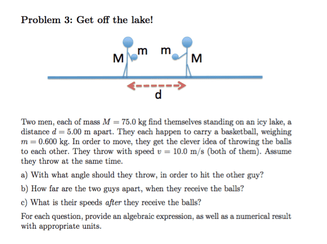

- We are taking a course in Newton mechanicsTwo men, each of mass M = 75.0 kg find themselves standing on an icy lake, a distance d = 5.00 m apart. They each happen to carry a basketball, weighing m = 0.600 kg. In order to move, they get the clever idea of throwing the balls to each other. They throw with speed v = 10.0 m/s (both of them). Assume they throw at the same time.
a) With what angle should they throw, in order to hit the other guy? b) How far are the two guys apart, when they receive the balls?
c) What is their speeds after they receive the balls?
For each question, provide an algebraic expression, as well as a numerical result with appropriate units.
