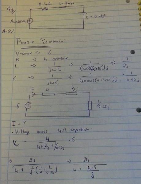

steady-state current through the loop will be of the form Bsin(1000t +b). What is the phase angle 'b'? in rads
[/B]
The answer is meant to be 0.46rads/s. However I am getting 9.65x10^-5??
I have no idea what I did wrong.
I first converted everything into the phasor domain. Then I used voltage division to get the voltage drop across the resistor. Then I used Ohms Law to get the current through the resistor which is the same as the current through the circuit.
Check your calculation for the impedance of the inductor. The formula for the impedance of an inductor is not he same as that of a capacitor.
Don't be afraid to promote j's in the denominator to the numerator. If you have a value like ##1/0.25j##, then this can become ##-4j##.
You don't need to do any voltage division here. Simply sum up the impedances to find the total impedance. Then apply Ohm's law directly: ##I = E/Z## (where E is the applied potential difference across Z).

It says in my lecture notes that inductors can be described be V = jwLI or I = 1/jwL * V
It says nothing else. How do I know like what to use when? I mean say I am converting a 2H inductance into the phasor form, how do I know what to use?
##Z_L = j \omega L##
##Z_C = \frac{1}{j \omega C}##
