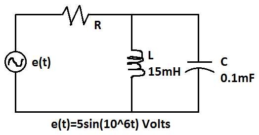

In the circuit shown below, find the value of the resistance R that is necessary to make the magnitude of V equal to 3 volts.
Can anyone please help me to solve this out?
rude man said:
Have you covered phasors?
No phasors is given bro...
In that case you have to write a differential equation . Write the diff. eq. for current entering node V from the source = current leaving node V through L and C. This actually starts as an integro-differential equation but you can change it to an ordinary diff. eq.
