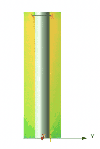

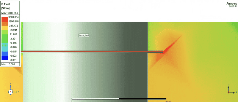

Hello! I think I have a better understanding of what is going on now. I was able to simulate the setup I am interested in (I am using Ansys) and it behaves as expected. One thing I wanted to ask which is not totally clear to me (but based on what I found online, the behavior is expected) is the following. I am simulating a quarter wave resonator (I attached some figures of the simulated setup) where the signal is injected using a loop of current (at the bottom right of the attached figure). Normally, the length of the inner resonator should be ##\lambda/4##. However, in my case, the end of the inner resonator is very close (in my case 0.5 mm) from another metal plate (the atoms will be between these 2 plates, experiencing a large oscillating electric field). If the distance between these 2 plates is large, the length needed is pretty close to ##\lambda/4##. However, in my case, (at a 0.5 mm spacing), the required length to achieve a given resonant frequency is much lower (in my case around 3 times smaller). Why is this happening? I assume it has something to do with the fact that I create some huge capacitance between these 2 plates? But I am not really able to write down some sort of effective circuit that would explain this significant length reduction. Could you please help me understand this effect better?
It is almost certainly that close spacing, at the open-end, that is lowering the frequency, by increasing the end-capacitance.
If you have a dielectric material inside the resonator, then it will have a lower frequency, as the transmission line has a lower velocity factor; vf ∝ 1/√Er. Another way to lower the frequency, is to place a lump of capacitance at the open end. Radio engineers will have two signal ports at the shorted end, then use the open-end capacitance to tune the resonator. But you must reduce the end capacitance, to that of the ion trap capacitance, by keeping the central conductor smaller in diameter than the typical radio filter example. You will need to shorten the resonator, but certainly not by a factor of three. If the central conductor is made too thin, it will have higher surface resistance, so the Q of the resonator will be lowered.
I assume you are designing for air or vacuum inside the resonator. Where the resonator penetrates the wall of the vacuum chamber, there must be a glass, or maybe polystyrene wall, somewhere. It is important that the presence of that dielectric does not mismatch the impedance of the resonator line, or greatly magnify the end capacitance.

Thank you for this! Are you saying that the factor of 3 I am getting is a mistake? Or that I can reduce the frequency without having to reduce the size by a factor of 3, if I want to (actually a smaller size is better for me, so the factor of 3 is great, actually, for my setup)?
I am not sure I understand the last part. I was planning to put everything inside the vacuum chamber and I thought that the inner rod would be soldered (or something similar) to the bottom of the outer wall. What is this polystyrene wall needed for? Also, when you say "resonator", do you mean the inner rod only, or the whole setup (inner rod + outer wall and the vacuum in between)?
It is a big change, so I am concerned that the Q will be low, or the centre frequency will be highly dependent on the small separation, so very temperature and pressure sensitive.
I would expect the resonator to penetrate the wall of the vacuum chamber, so the RF connection, coupling, and possibly the tuning could be done externally, from behind.

Thank you for the clarifications. Sorry for not providing more details about the simulated setup. The resonance I am aiming for is ~35 MHz, corresponding to ##\lambda/4 \approx 2.1## m. The size of my setup in the simulation, reaching a resonance at 35 MHz is ~ 0.65 m, so 3.2 times smaller (it seems I can make it even smaller by adjusting the diameter of the rod and/or the diameter of the outer wall). I did not check the Q-factor, but in the second picture above, based on the simulation, the field between the plates is ~10 kV/cm (for 1 W of input power), which is what I need for my experiment. I don't care too much about the Q value itself, I just need to reach 10 kV/cm electric field and I assumed that 1 W of input power is reasonable (I saw papers, including the PhD thesis I shared before, that go up to 15 W). Am I missing something else here? I will look into the variation of the resonant frequency and Q with the gap between the 2 plates, but again, from literature, people claim they can have that distance controlled at the ~ 1-2 micron level.
When you say "I would expect the resonator to penetrate the wall of the vacuum chamber", do you mean the outer wall, or the inner rod? I imagined that the inner rod is completely encased in the outer wall, then everything is placed inside a vacuum chamber (I will need a way to support the outer resonator wall on the chamber walls, but that won't affect what is happening inside i.e. that won't affect the resonant frequency or the Q factor) and use a vacuum feedthrough to send the RF signal from air to vacuum (i.e. I thought everything in the figure above would be fully placed inside vacuum).
I mean the outer tube.
Now that you inform me the frequency is close to 35 MHz, not hundreds of MHz, I would expect the resonator to be made from a helical coil with a capacitor.
