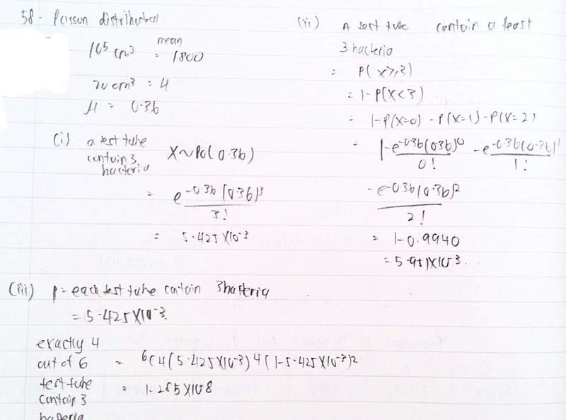

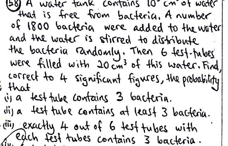

i am having problem with part iv ) . the ans is 0.04519 . can anyone tell me how to do this ? i have solved part i , ii and iii ..p/s line 1:
A tank contain 10^5 cm3 of water

You seem to make a habit of violating PF standards: you keep posting thumbnails, when--officially--you are supposed to type things out. I cannot read your thumbnails on some media, and on the computer I am using now the part you want to know about (part (iv)) does not even show up in the attached picture!

A water tank contains 10^5 cm3 of water that is free from bacteria. A number of 1800 bacteria were added to water and water is stirred to disrtibute the bactria randomly. Then 6 test tube were filled with 20cm3 of this water. Findthe probability of
a) a test tube contain 3 bactria
b) A test tube contain at least 3 bacteria
c) exactly 4 out of 6 test tube with each contain 3 bacteria
d) 6 test tube conatin a total of 5 bacteria
i got stucked at part d .
Do you know that your answers to a, b, and c are correct? If not, please post your answers.
For (d), what are all the possible distributions of the 5 between the 6 test tubes?

so my working would be (e^-0.36)x 0.36 = 0.2511
step 2 : 6c5 ( (0.2511)^5 )x ( (1-0.2511)^1 )= 4.49x10^-3
do you mean we can assume for 6 test tube , each conatain only exactly one bacteria?
What are you calculating there, and how? Please show all steps.
i assume each tube contain only 1 bacteria.
