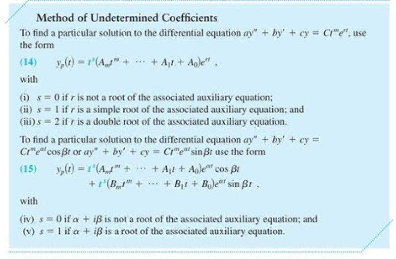

Solve ODE
[tex]y''-y=e^{-t}[/tex]
[tex]y(0)=1, y'(0)=0[/tex]
Homogenuous solution
[tex]t^2-1=0[/tex]
[tex]y=C_1e^t+C_2e^{-t}[/tex]
From
[tex]y=\frac{1}{2}e^t+\frac{1}{2}e^{-t}[/tex]
How from that get complete solution?
It's wrong. What you have to do it write:
[tex] y=C_{1}e^{t}+C_{2}e^{-t}[/tex]
and then find the particular integral, call it [itex]f(x)[/itex] say, and then apply the boundary condition to the function:
[tex] y=C_{1}e^{t}+C_{2}e^{-t}+f(x)[/tex]
How to find particular integral?
I would look for a function
[tex] y=Ate^{-t}[/tex]
and likewise.
How do you know how to look for the function?
How you choose form of particular solution?
Hi matematikuvol! :smile:
It is called the method of undetermined coefficients.
You can find it in wikipedia, although not quite in the form you need:
http://en.wikipedia.org/wiki/Undetermined_coefficients
Here's a better definition (just posted by another HH! :wink:):
As an alternative you could use the method of Variation of parameters:
http://en.wikipedia.org/wiki/Variation_of_parameters
