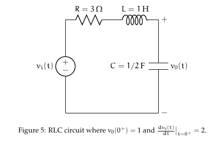

Determine the differential equation relating \(v_i(t)\) and \(v_0(t)\) for the RLC circuit in the figure.
Would this just be
v_i(t) = 3i + \frac{di}{dt} + 2\int i(t)dt
but \(v_0 = 2\int i(t)dt\). Do I need write it as \(v_0\) or as \(2\int i(t)dt\)?

Correct is...
$\displaystyle v_{i} (t) = 3\ i + \frac{d i}{d t} + 2\ \int_{- \infty}^{t} i(\tau)\ d \tau$

Is it possible to solve for \(v_0(t)\) using a Laplace transform?
Yes. In fact, electrical engineers will typically write down circuit elements on the diagram with their Laplace-transformed expressions, so that the very first equation they write down is the LT'ed equation.

Suppose \(v_i(t) = e^{-3t}\mathcal{U}(t)\). Then how can we get back \(v_0\) from a Laplace transform?
If I take the Laplace transform of
e^{-3t}\mathcal{U}(t) = 3i + \frac{di}{dt} + 2\int_{-\infty}^ti(\tau)d\tau,
I get
i(t) = -\frac{3}{2}e^{-3t} + 2e^{-2t} - \frac{1}{2}e^{-t}.
How do I get to \(v_0(t)\) for \(t > 0\)?

Sorry for the delay. This is called $s$-domain circuit analysis. You have the $s$-domain impedances (kinda like what you have in steady-state sinusoidal analysis with phasors):
\begin{align*}
Z_{R}&=R \\
Z_{L}&=Ls \\
Z_{C}&= \frac{1}{Cs}.
\end{align*}
These come straight from the V-I characteristics of resistors, capacitors, and inductors: just LT those relationships, and compare with $V=IZ$, Ohm's Law, to get the $s$-domain impedances (these are defined with the initial conditions zeroed out).
There are tricks for dealing with initial conditions as well - you usually insert a voltage or current source to handle that. Here is a good summary of the method.

I had the solutions in my office which I retrieved yesterday. It has that
i(t) = \frac{1}{2}\frac{dv_0(t)}{dt}
where does this identity come from? I know we have that \(\dot{v}_0(t) = 2\) but how does that equate to \(2i(t)\)?

This comes from the $VI$ characteristic of a capacitor. For any capacitor of capacitance $C$, it is true that $i=C dV/dt$. Since you have a series $RLC$ circuit, all the current goes through the capacitor. Since $C=1/2$ in your case, that's how you get $i=(1/2) dv_0/dt$.

Shouldn't this be
$$\frac{1}{s + 3} = \frac{3}{2}(sV_0(s) - v_0(0)) + \frac{1}{2}(s^2V_0(s) -
sv_0(0) - v_0'(0)) \color{red}{+V_0(s)}?$$
