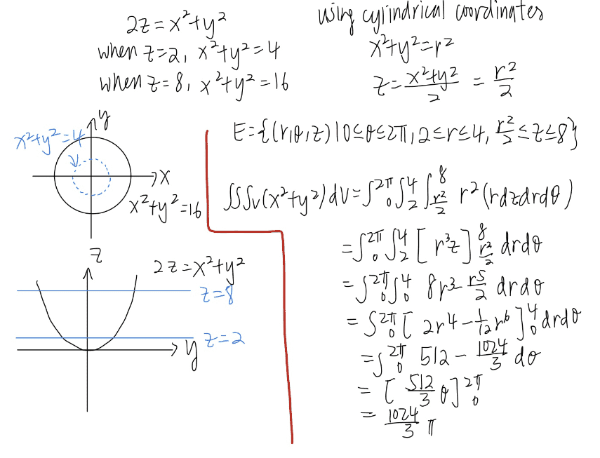

(question is attached below)
x^2+y^2=r^2
dV=rdrdzdΘ
I am trying to solve it using cylindrical coordinates, but I am not sure whether the my description of region E is correct, whether is the value of r is 2 to 4, or have to evaluate the volume 2 times ( r from 0 to 4 minus r from 0 to 2), and whether is okay to take z from r^2/2 to 8

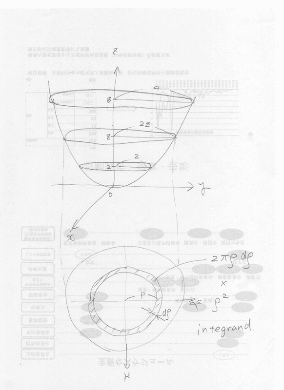

\int_2^8 dz \int_0^{2z} 2\pi \rho^3 d\rho
Likes Delta2
May I know which method did you use? I have no idea of it, thanks

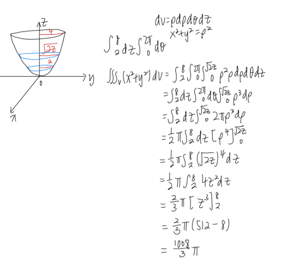

Find attached my handwriting.
Likes daphnelee-mh
Shouldn't the boundary of integration be ##\sqrt{2z}## instead of ##2z##?
Likes anuttarasammyak
Yes. Thanks for correction.
Likes Delta2
Can you help to see whether this is correct ? Thank you
Yes it looks correct to me.
Thank you so much
