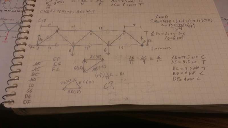

In the attached problem, I don't understand why members CD and DE are equal to 0. I was under the impression that the combined vertical components of BC and CD should equal 6+downward components of BC and EF, as to counteract the force straight down, but this is not the case.
My questions:
Why are the forces in members CD and DE equal to zero?
If they are equal to 0, what stops the downward force from moving the structure?
Thank you
Note: G and Ay are 6 and 6, not 8 and 6 as shown. I used the right values for my calculations, but for some reason wrote 8 down

It's not clear from your post: Who is saying that members CD and DE are equal to 0? Are you talking about the forces in these members?
Sorry yes - that's what I meant.
You still haven't answered the main question: who is saying that the forces in members CD and DE are equal to 0?
The answers in the back of the textbook
IF THE STRUCTURE AND LOADING ARE BOTH SYMMETRICAL THEN THE EQUILIBRIUM OF JOINT d REQUIRES SYMMETRY OF FORCES IN cd AND de. tHAT IS THE CLUE...
