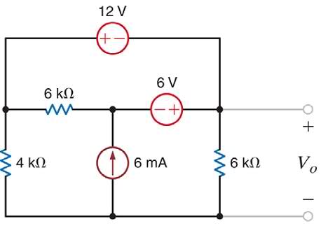

I have to solve for V0 , using nodal analysis. I am getting different answers in MATLAB and PSPICE. The circuit is below
2 supernodes ; or 1 big supernode Here are my nodal equations:
v1-v3 = 12
v3 - v2 = 6
(v3)/6k + (v1)/4k - 6/k = 0

I = V/R
I have gotten -4.2 from MATLAB and 7.2 from pspice.
Try grounding the node connected to 2 voltage sources. This will simplify the analysis by only having to solve for a single node voltage.
I have solved this by hand and I can tell you that your equations, and pspice are correct.
I just wonder about what it is you're 'saying' by that MATLAB code, I will have to look at it in more depth.
Clearly the Matlab answer is wrong since it does not satisfy the III equation:
(v3)/6k + (v1)/4k = -4.2/6k + 7.8/4k = -.7/k + 1.9/k =1.2/k != 6/k
On closer inspection, you will see that the conversion from
to
A=[1,0,-1;0,-1,1;.004,0,.006] is erroneous -
1/4k != .004, 1/6k != .006
