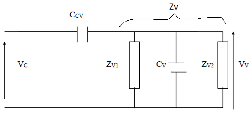

Given ZV1 = ZV2 = 100Ω,
ZCCV = ZCV = 2000/j = -2000j, and
VV/VC = 0.04789.
I'm trying to get the given VV/VC result.
I know that
1/ZV = 1/ZV1 + 1/ZV2 + 1/ZCV
VV = ZV / (ZV + ZCCV) * VC
1/ZV = 1/ZV1 + 1/ZV2 + 1/ZCV = 1/100 + 1/100 + j/2000
|1/ZV| = √(0.022 + (1/2000)2) = 0.02
ZV = 50Ω
VV/VC = ZV / (ZV + ZCCV) = 50 / (50 - 2000j)
VC/VV = (50 - 2000j) / 50 = 1 - 40j
|VC/VV| = √(12 + 402) = 40.01
VV/VC = 1/40.01 = 0.02499
which is about half of the value I should get.
Where did I go wrong?
Kirkoffs laws - check arithmetic.
Can I please have a bit more hint?
The voltage through ZV1, ZV2 and CV is the same (VV), right?
