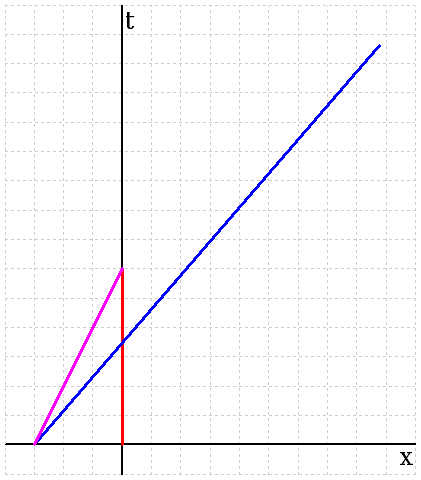

Maybe this will help. It's a slightly simplified version of your problem - in ship A's frame, the shuttle simply drops instantly to 0.5c and stays at constant velocity until intercept. Here is the Minkowski diagram (simply a displacement-time graph) for the scenario as observed by ship A:
I've drawn ship A's worldline in red. It stays stationary at the origin. I've shown ship B's worldline in blue - it's moving at ##\sqrt 3c/2##. I've drawn the shuttle in blue, launched at -3 light seconds and moving at a constant 0.5c. The horizontal scale is 1 light second per grid square; the vertical is 1 second per grid square.
Now here's the same scenario as drawn by ship B:
The scale is the same (apologies - the axes should be labelled x' and t', but I've only just seen that the primes are missing). In this case, ship A is moving with velocity ##-\sqrt 3c/2##, ship B is stationary at x'=-6. As you can see, at the time of launch, the separation between ships A and B is indeed 1.5 ls, half the value in ship A's frame. However, this is largely irrelevant as the shuttle never crosses this gap - it's moving to the left by about 4.5 ls.

@PeterDonis - I agree with your maths, but had read the OP's #7 as conceding that the initial question was flawed and asking a revised question, which I think I answered. However, I've now connected this thread to the proper distance thread from the other day, so a clarification might be in order.
@rede96 - In ship A's frame the shuttle launches as ship B passes the marker, 9,000,000km from ship A, and crosses the 9,000,000km decelerating steadily to rest.
In ship B's frame the shuttle launches as the marker passes ship B, 4,500,000km ahead of ship A. It accelerates in the direction away from ship A, eventually matching position and velocity with it 9,000,000km from ship B.
This is basically drawn in my diagrams, the only corrections being that the purple line should be a hyperbola and that the launch-to-ship-A distance in the first diagram should equal the ship-B-to-intercept distance in the second.
The important thing to note is that these 9,000,000km distances are not measuring the same thing. In ship A's frame it is the distance from the marker to ship A. In ship B's frame it is the distance from ship B to the intercept point. Neither of these distances is 9,000,000km in the other frame - in fact, the second one isn't unambiguously defined in ship A's frame.
Finally getting back to mission planning, one could work in either frame. In either frame the coordinate distance between marker and ship A is a relevant datum. In the rest frame of ship A that happens to be the proper distance between the two, and that is the only frame where the coordinate distance is the same as the distance traveled by the shuttle.
I'm inclined to think that this whole "proper distance" concept is unhelpful because, at least for this kind of scenario, it's irrelevant to practical calculations. Proper time is useful because it's a "distance travelled" measure along time-like world lines. I'm not sure how often one needs the equivalent concept of "distance travelled" along space-like world lines.
