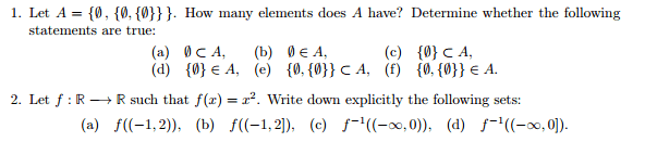

Q.1
I'm a little confused with how subsets and elements are defined in the case of the given set "A" as it seems to be a set of sets, so I'm going to throw my answers out and would appreciate any guidance on where I'm wrong (if anywhere).
[itex]A = \Big\{\emptyset, \big\{\emptyset, \{\emptyset\}\big\}\Big\}[/itex]
"A" has two elements
a) [itex]\emptyset\subset A[/itex] - True
b) [itex]\emptyset\in A[/itex] - True
c) [itex]\{\emptyset\}\subset A[/itex] - Not true
d) [itex]\{\emptyset\}\in A[/itex] - Not true
e) [itex]\{\emptyset, \{\emptyset\}\}\subset A[/itex] - True
f) [itex]\{\emptyset, \{\emptyset\}\}\in A[/itex] - True

You shouldn't post two questions in 1.
I don't agree with your answers. Which ones are you sure about?

My problem I think lies in that I don't understand the difference between [itex]\{\emptyset\}[/itex] and [itex]\emptyset[/itex]
To me it seems that one is the empty set, and the other is a set with the empty set in, which is just the empty set, so they're the same. This surely isn't the case because it makes things too trivial, but I don't know how else to interpret those two things.

There is a difference between the element ##a## and the set containing ##a##, denoted by ##\lbrace a \rbrace##. Similarly for the empty set. The set containing the empty set is not empty! It has one member: the empty set.

Excellent, thanks, I think it's all clicked now. Updated answers are below.
a) [itex]\emptyset\subset A[/itex] - NOT True because [itex]\emptyset[/itex] is just an element, not a set, and therefore cannot be a subset
b) [itex]\emptyset\in A[/itex] - True because it is an element of A
c) [itex]\{\emptyset\}\subset A[/itex] - True since [itex]A = \Big\{\emptyset, \big\{\emptyset, \{\emptyset\}\big\}\Big\} = \{\emptyset\}\cup \Big\{\big\{\emptyset,\{\emptyset\}\big\}\Big\}[/itex], so clearly [itex]\{\emptyset\}\subset A[/itex]
d) [itex]\{\emptyset\}\in A[/itex] - NOT true, this set is not en element of A.
e) [itex]\{\emptyset, \{\emptyset\}\}\subset A[/itex] - NOT True, it is only an element.
f) [itex]\{\emptyset, \{\emptyset\}\}\in A[/itex] - True.
To a): Can you tell all subsets of ##A=\{1,2\}\, ?## How many are there? Why doesn't the argument under c) apply?

Hmm, I hope I'm right in saying [itex]\emptyset, \{1\}, \{2\}, \{1,2\}[/itex] are subsets of [itex]\{1,2\}[/itex].
This now leads me to question my result for part a) however...
Another way I'm seeing it is that the empty set is {} , hence {}, {1}, {2} and {1, 2} are subsets of {1,2}
So for { 0, {0,{0}} }, the subsets are {}, {0}, { {0,{0}} } and { 0, {0,{0}} }
and {} is the empty set ##\emptyset##
hence ##\emptyset \subset A## ..?
Yes, the empty set is always a subset, regardless what is in the set. You said it already under c) : ##A=A\cup\{\} \Rightarrow \{\} \subseteq A##.

So just to check - the answers I gave for a) to f) were correct apart from part a), which should have been 'true' since ##\emptyset## is always a subset of any set.
If I didn't become confused myself, yes. In the original post c) and e) were wrong. e) could be "repaired" to be true with an additional bracket around: ##\{\{\emptyset, \{\emptyset\}\}\} \subsetneq A\,,## because the element would be then in a set.
