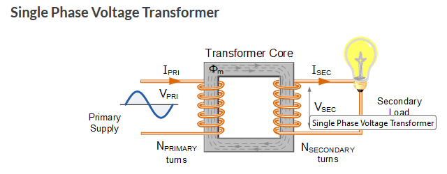

@saadm
This is a very old link I have. Hope it still works.
https://www.electronics-tutorials.ws/transformer/transformer-basics.html
Link still works, but the flux direction looks backwards to me. That shouldn't be a problem for the OP's questions, but it looks odd to me...
berkeman said:
... but the flux direction looks backwards to me.
You're right. I never noticed that.

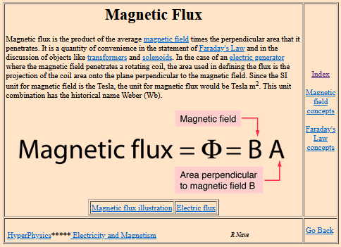

saadm said:
i). What exactly is magnetic flux linkage as oppose to just magnetic flux?
The magnetic flux ##\Phi## is related to the magnetic field ##B## and the cross-sectional area ##A## that that field is present in. The simple equation is ##\Phi = BA##
The difference between total flux and flux linkage may be due to the geometry of the magnetic core, where almost all of the flux is contained. If you have a multi-leg transformer core, like an E-E or E-I core, then the windings on the bobbins on the multiple legs may not receive all of the flux from the primary source coil. If you have an E-E core transformer with one primary bobbin and two secondary bobbins, then each or the two secondary bobbin windings will receiver about half of the total flux generated by the primary coil, so the flux linkage would be about half for each of those secondary coils.
http://hyperphysics.phy-astr.gsu.edu/hbase/magnetic/fluxmg.html

Interesting point. I guess my intuition is lazy, but the flux clearly has a direction with respect to the cross-sectional area of the magnetic core. Otherwise, there would be no way to calculate the voltages and currents in transformers.

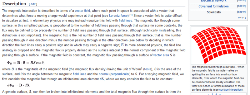

The scalar flux ##\Phi## is defined by the vector dot product equation involving the vector ##B## and the vector area element(s) ##dA##, so the sign of the flux direction is determined by those vectors, and hence the sign/direction of the little ##\Phi## arrows in the figure that I commented on was wrong. Would you agree with that part?
https://en.wikipedia.org/wiki/Magnetic_flux
After thinking more about this, it seems like even though ##\Phi## is a scalar, it has an implied direction in the case of a magnetic core (at least for the flux that contributes to ##L_m## and not ##L_k##). Just as the scalar speed of a vehicle has an implied direction when traveling on a road...
As a scalar a flux has a sign (not a direction!), which is relative to the arbitrary choice of the two possible directions of the surface-normal vectors. It's most intuitive for real fluxes like the flux of electromagnetic charge. In the fundamental Maxwell equations it's described by the current density ##\vec{j}##. It's meaning is that for a given oriented surface the current (i.e., the flux of the current density),
$$I=\int_A \mathrm{d}^2 \vec{f} \cdot \vec{j}$$
is the charge per unit time flowing through the surface, with the sign of the contribution of any surface element ##\mathrm{d}^2 \vec{f}## determined by the choice of the direction of this surface-normal-vector element.
