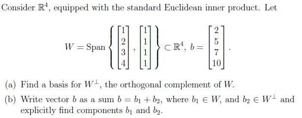

Problem statement in R^4 with the standard inner product: W is the span of vectors (1,2,3,4) and (1,1,1,1), and b = (2,5,7,10). Parts (a) find a basis for the orthogonal complement W-perp, and (b) decompose b as b1 + b2 with b1 in W and b2 in W-perp.
I've solved part a)..
But I am stuck on part b) I have no idea where to start the problem or what to actually use to actually attempt solving this part. So a suggestion as to what I can actually do, would be very helpful!thank you in advance.
For the last part, one idea that comes to mind is that [itex]b_1 \in W[/itex] and [itex]b_2 \in W^{\perp}[/itex] means that [itex]b_1 = a \begin{pmatrix} 1 \\ 2 \\ 3 \\ 4 \end{pmatrix} + b \begin{pmatrix} 1 \\ 1 \\ 1 \\ 1 \end{pmatrix}[/itex] for some [itex]a,b \in \mathbb{R}[/itex] and similarly [itex]b_2[/itex] would be a linear combination of the basis you found for [itex]W^{\perp}[/itex].
Well I think I've solved it, finally... If I'm correct, I got
[itex]b = \begin{pmatrix} 2\\ 5 \\ 7 \\ 10 \end{pmatrix} = b_1 \begin{pmatrix} 8.1 \\ 10.2 \\ 12.3 \\ 14.4 \end{pmatrix} + b_2 \begin{pmatrix} -6.1 \\ -5.2 \\ -5.3 \\ -4.4 \end{pmatrix}[/itex]
Also can anyone explain the first question to me? Thanks, in advance!
