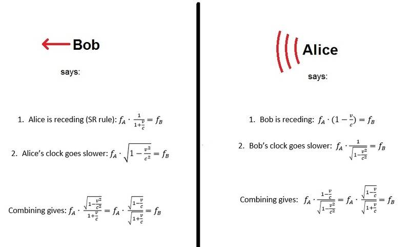

Good day,
I was playing a bit with a Doppler effect scenario and tried to combine it a bit with Special Relativity and I concluded something that I don’t quite understand, or that I at least don’t get the meaning of. I am aware that the scenario and my concluded formula don’t describe the full Relativistic Doppler effect but the result got me interested.
The scenario is the following:
Person A is moving away from Person B. Person B is holding a lasergun that emits a specific frequency of light pulses towards A.
Because of Special Relativity, Person A who is moving away would still measure the light pulses approaching him at c and he would think that Person B with the lasergun is moving away from him instead. From the Doppler asymmetry, Person A would therefore conclude that the time duration t between each light pulse that he’d receive is calculated by:
P x (1 + v/c) = t (Lightsource moving away)
In which P is de original time period between the light pulses (1 / f) that Person B is shooting.
However, Person B with the lasergun measures the light pulses going away from him at c and think that Person A is moving away from him. From the Doppler asymmetry, he’d think that person A would measure a time duration t’ between his light pulses which is calculated by:
P / (1- v/c) = t’ (Observer is moving away)
Out of curiosity, I then wanted to calculate the factor by which t and t’ are separated by calculating the ratio of these 2 formulas:

What got me surprised, is that this concluded ratio of t’ and t is equal to the Lorentz factor squared. However, I don’t get exactly why this is the case. Is this just coincidence or does it have a meaning and if so, what’s the meaning behind it? From what I understand, time dilation between 2 observers should be always separated merely by the Lorentz factor, not the square of it.
I’m very new to this so could someone please enlighten me on this in a simple way?
In neither of your scenarios did you account for time dilation. In the first scenario, you have to apply the time dilation along with applying the Doppler effect.
In other words, if P is the time between pulses as measured by B, Then
[tex]\frac{P}{\sqrt{1-\frac{v^2}{c^2}}}[/tex]
will be the time between pulses emitted by B according to A. Applying the your Doppler shift expression to this will give the time between pulses measured by A, This will work out to.
[tex]P \sqrt{\frac{1+\frac{v}{c}}{1-\frac{v}{c}}}[/tex]
In the second scenario, According to B, A's clock is running slow by the Lorentz factor, and so while B measures the pulses striking A by the time period your equation gave, he wouldn't expect A to measure that same time period due to A's slower running clock.
When you factor this in, you end up with the same answer as above as to the time period measured by A between received pulses. A and B must agree as to how much time A measures measures between pulses by his clock.
Time dilation and Doppler shift are two different effects and the reason you got the answer you got was due to neglecting one of them in both scenarios.

Yes, if you don't include time-dilation for the moving observer, then the Doppler shift measured by the moving observer for signals sent by the stationary observer is:
[itex]f_1 = 1-\frac{v}{c}[/itex]
while the Doppler shift measured by the stationary observer for signals sent by the moving observer is:
[itex]f_2 = \frac{1}{1+\frac{v}{c}}[/itex]
with the ratio being [itex]\frac{f_2}{f_1} = \frac{1}{1-\frac{v^2}{c^2}}[/itex]
So without time dilation, you could tell who was "really" moving by looking at the Doppler shift.
Now, let's go through the same calculation including an unknown time dilation factor [itex]g[/itex].
The rate that the moving observer will measure signals will be greater because he's using a slowed clock. So instead of measuring [itex]f_1[/itex] above, he'll measure [itex]f_1' = g f_1[/itex]
If the moving observer's clock is running slow, then the rate at which he will produce signals will be smaller by the factor of [itex]g[/itex]. So the rate measured by the stationary observer will be, not [itex]f_2[/itex], but [itex]f_2' = f_2/g[/itex]. Now, the ratio of the two modified rates will be:
[itex]\frac{f_2'}{f_1'} = \frac{f_2/g}{g f_1} = \frac{1}{g^2} \frac{f_2}{f_1} = \frac{1}{g^2} \frac{1}{1-\frac{v^2}{c^2}}[/itex]
So if you choose [itex]g = \frac{1}{\sqrt{1-\frac{v^2}{c^2}}}[/itex], then the two modified frequencies will be the same, and there will be no way to tell who is moving.
So the principle of relativity (there is no absolute notion of "moving" versus "stationary") together with the classical Doppler shift implies the relativistic time dilation factor.

OK. Maybe I got the idea now

I think you're getting the various frequencies mixed up. Let me enumerate them:
[itex]f_{saa}[/itex]: the frequency at which Alice sends signals, as measured by Alice's clocks.
[itex]f_{rba}[/itex]: the frequency at which Bob receives signals, as measured by Alice's clocks.
[itex]f_{rbb}[/itex]: the frequency at which Bob receives signals, as measured by Bob's clocks.
[itex]f_{sba}[/itex]: the frequency at which Bob sends signals, as measured by Alice's clocks.
[itex]f_{raa}[/itex]: the frequency at which Alice receives signals, as measured by Alice's clocks.
