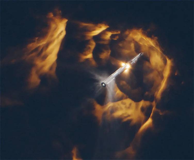

  • #202
No, this isn't scifi!
It's hot stage separation.
(photo compliments of SpaceX via X)
  • Love
  • Wow

  • #205
Incredible image, worthy of using as an avatar!
