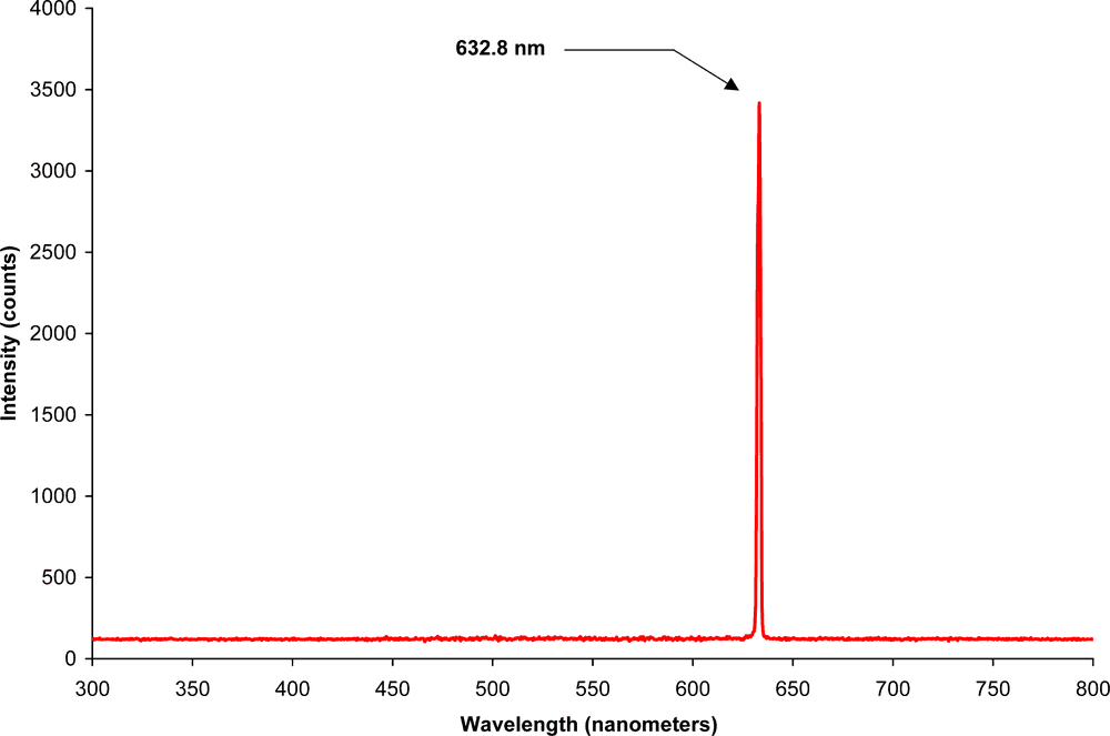

Hello,
If I shine a red laser onto a white surface, I assume that:
  • some of the red light will be nearly instantly reflected,
  • some will be absorbed and converted into phonons
  • and some will be absorbed and re-emitted.
Is that correct?
I know that my laser has this extremely narrow spectrum:
but what spectrum does a white surface emit when I shine it with said laser?
Thanks in advance.

It's likely to differ slightly depending upon the nature of the white surface, but the vast majority of the reflected energy will normally be at ## \lambda=632.8 ## nm.:welcome:

I don't have any spectrums. For a white paint, there is always the possibility that some fluorescence will occur. In addition, if there is some absorption, there will be heating of the surface for possible infrared emissions. (Just because it is high reflectivity, near zero emissivity in the visible doesn't mean the infrared emissivity will be near zero.)
In general, because of the low signal level expected at wavelengths other than ## \lambda=632.8 ## nm, it's not something that would be commonly measured. In addition, the results will differ depending on the composition of the visibly reflective material.
The line width of lasers is pretty narrow. So you really won't see any change do to "color", i.e. wavelength dependent reflection or absorption. That is why spectrometers have either a tunable source or a broadband source (i.e. white light). So, the spectrum you see reflected (or absorbed) will be the source wavelength, since that's all there is. The details of that spectrum depend on the design of the laser (primarily cavity length).

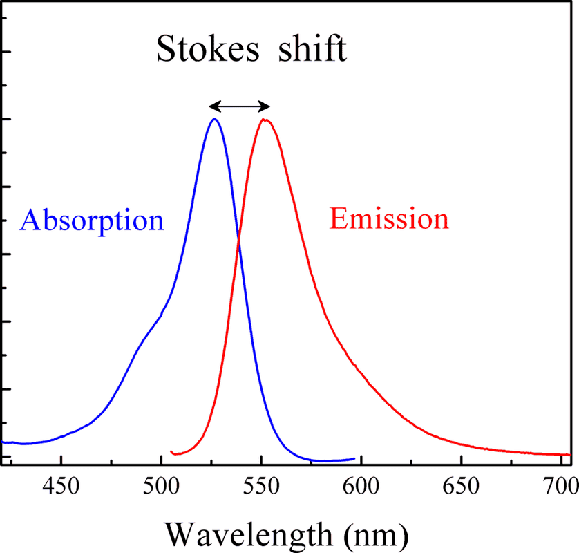

When light is absorbed and re-emitted it can have different wavelengths (stokes shift and anti-stokes shift)
Ah yes. A non-classical effect, I think? I was thinking that's outside the scope of the original question which refers to a "white object". That sort of implies a regular optics question but the situation is actually more interesting. I should have looked at the helpful A rating of the post.
