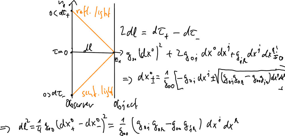

Here's an infinitesimal Minkowski diagram defined by the observer's tetrad. The derivation is from Landau&Lifshitz vol. 2. There you find a very clear discussion of spacetime geometry/tensor analysis.
@vanhees71 I've finally found the time to look into the textbook you cited. But if you're transcribing the discussion starting from equation 84.1 on, it's just to determine the ##dl## from the ##d\tau##, and the authors assume that c is an invariant. It's not used to show that the measured speed of light is an invariant in GR.

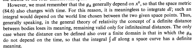

I'm quoting from the textbook, just before eq. 84.4 (sorry for the bad formatting):
SupposealightsignalisdirectedfromsomepointBinspace(withcoordinatesxa+dxa)toapointAinfinitelyneartoit(andhavingcoordinatesxa)andthenbackoverthesamepath.Obviously,thetime(asobservedfromtheonepointB)requiredforthis,whenmultipliedbyc,istwicethedistancebetweenthetwopoints.

I'm citing from said textbook, just before eq. 84.8:
  • #98
Pyter said:
The measured speed of a faraway light beam depends on the metric, and the metric generally depends on time.
Well, no you're not "citing from said textbook". The textbook is saying one thing and you're saying something entirely different!

@PeroK I meant that the speed of light depends on the metric, and thus time, through the ##\int dl##.
  • #100
It's still wrong and not at all what that text is saying. That text does not even mention the speed of light, let alone say it "changes with time".
