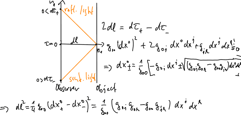

For local distance measures of space wrt. an observer one can use the constancy of the (two-way!) speed of light to define the distance of a infinitesimally distant point from him by sending a light signal and measures the time when he receives the reflected light signal. For the light signals you have
$$g_{\mu \nu} \mathrm{d} x^{\mu} \mathrm{d} x^{\nu} = g_00 (\mathrm{d} x^0)^2 + 2 g_{0k} \mathrm{d} x^0 \mathrm{d} x^k + g_{jk} \mathrm{d} x^j \mathrm{d} x^k=0.$$
For this you get two solutions for ##\mathrm{d} x^0## describing the coordinate times needed for the light signal to move forth and back
$$(\mathrm{d} x^0)_{\pm}=\frac{1}{g_{00}} \left (-g_{0k} \mathrm{d} x^{k} \pm \sqrt{(g_{0j} g_{0k}-g_{00} g_{jk})\mathrm{d} x^j \mathrm{d} x^k} \right).$$
The coordinate-time difference thus is
$$\mathrm{d} \Delta x^0=(\mathrm{d} x^0)_+ -(\mathrm{d} x^0)_- = \frac{2}{g_00} \sqrt{(g_{0j} g_{0k}-g_{00} g_{jk})\mathrm{d} x^j \mathrm{d} x^k}.$$
The time measured by the observer between the sending the light signal and receiving the reflected one is
$$\mathrm{d} \tau = \sqrt{g_{00}} \mathrm{d} \Delta x^0.$$
So the distance as measured by the observer is half that. So we finally have
$$\mathrm{d} l = \sqrt{\frac{g_{0j} g_{0k}-g_{00} g_{jk}}{g_{00}} \mathrm{d} x^j \mathrm{d} x^k}.$$
In this way, for sufficiently small distances, one sees that in GR as in SR the (two-way) velocity of light is just 1 by convention.
  • #48
Why is there a negative solution for ##\mathrm{d}x^0##?
I don't get the physical meaning of this difference. Why should it be the round-trip duration in coordinate time?
How do you compute the distance from the proper time ##\mathrm{d}\tau##? Do you multiply it by ##c \triangleq 1##?
vanhees71 said:
So we finally have
## \mathrm{d}l = \mathrm{d} \tau /2 ##? I don't follow.
  • #49

  • #50
Here's an infinitesimal Minkowski diagram defined by the observer's tetrad. The derivation is from Landau&Lifshitz vol. 2. There you find a very clear discussion of spacetime geometry/tensor analysis.

##\mathrm{d} s^2## is defined as
$$\mathrm{d} s^2=g_{\mu \nu} \mathrm{d} x^{\mu} x^{\nu}$$
along a worldline, described by a function ##x^{\mu}(\lambda)## of the coordinates with an arbitary parameter ##\lambda##. Parametrized in this way you can also write
$$\mathrm{d} s^2 = \mathrm{d} \lambda^2 g_{\mu \nu} \dot{x}^{\mu} \dot{x}^{\nu}.$$
In my postings above (#47 and #50) in the argument how to measure infinitesimal spatial distances between an observer (the left vertical worldline in the picture of #50) and an arbitrary point (right vertical worldline in the picture of #50) by "radar timing", which is one way to define infinitesimal spatial distances in GR using that in a local inertial frame the two-way speed of light is ##c##, I used (a) the worldlines of the light signals, which are necessarilly "null worldlines", characterized by ##\mathrm{d} s^2=0##, and (b) the worldline of an observer who is defining a local inertial reference frame by using his four-velocity as time-like basis vector of a tetrad. He is using his clock to measure the time from sending out his signal and receiving the signal reflected on the object the distance he wants to measure. For his wordline, defined by being momentarily at rest in the sense of the coordinates ##x^{\mu}##, i.e., ##\mathrm{d} x^j=0## (where ##j \in \{1,2,3\}##). The time measured by his clock is his "proper time" and given in the used coordinates by
$$\mathrm{d} \tau^2=\mathrm{d} s^2=g_{00} (\mathrm{d} x^0)^2.$$
I used a natural system of units where ##c=1##.
