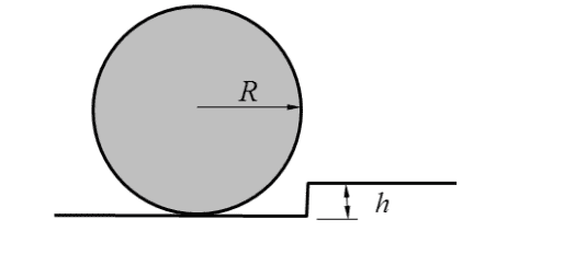

A sphere of radius R is rolling without slipping with a velocity v and collides inelastically with a step of height h < R. ¿What is the minimum velocity for which the sphere will be over the step?
Total kinetic energy (maybe):
\frac{1}{2}I\omega^{2}+\frac{1}{2}mv^2
Gravitational potential energy:
mgh
Moment of inertia about a point a distance d from the CM from de center of mass:
I=I_{cm}+md^{2}
Rolling without slliping
v=\omega R

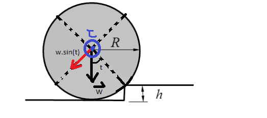

3. A discussion of the problem
This problem is confusing to me: I know the collision is inelastic so there is no conservation of kinetic energy, there is torque when the sphere pivots the step so the angular momentum is not conserved either, the linear momentum doesn't give a lot information and even though I tried to see what condition needs the torque about the pivot point (to give a net torque in the direction of rotation and thus passing the step), I'm not able to see what torque can compensate the one from gravity which doesn't let the sphere slide up:
The sphere has an angular velocity, but I'm missing something conceptual because I can't figure out how to formally state that the angular momentum changed the right amount so that the sphere made it past the step.
4. The attempt at a solution
My (possible wrong) attempt was to say that the sphere lost kinetic energy because of the change on potential energy:
\frac{1}{2}I\omega^{2}+\frac{1}{2}mv^2 +mgR = mg(R+h)\\<br /> v=\sqrt{\frac{10}{7}gh}
I hope you can help me :)

Well, not exactly. We typically assume the collision lasts a very short time, such that the gravitational impulse, and the normal impulse from the ground, are ignorable. The torque due to gravity and the lower ground are justifiably ignored in the limit of a small collision time, because the corner force becomes more and more like a dirac delta spike and is thus the dominant effect in that limit.
With that said, yes.

Well one key relation is that the collision is perfectly inelastic, which we can interpret as meaning that after the collision, the contact point is stuck, meaning it purely rotates about that point after the collision. So we have a ball rolling towards a corner, we know the exact motion of this rolling, and then we know that it purely rotates about that corner after they collide, we just don't know with what angular speed. Well you've pointed out that angular momentum is conserved about that pivot, so, if you are careful, you should be able to determine the angular speed which gives the same angular momentum immediately after the collision as there was before the collision.
Then your energy considerations should help in determining if that angular speed is sufficient to reach the top.
