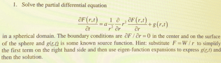

I have a PDE and I need to solve it in spherical domain:
$$\frac{\partial F(r,t)}{\partial t}=\alpha \frac{1}{r^2} \frac{\partial}{\partial r} r^2 \frac{\partial F(r,t)}{\partial r} +g(r,t) $$
I have BC's:
$$ \frac{\partial F}{\partial dr} = 0, r =0$$
$$ \frac{\partial F}{\partial r} = 0, r =R$$
So, in spherical coord.
First, I know that:
$$F=w/r$$
Reducing, I get:
$$\frac{\partial w}{\partial t} =\alpha \frac{\partial^2 w}{\partial r^2}+r*g(r,t) $$
[/B]
After I Get this, I need to find eigenfunction expansions to express the source term and
then, finally, the solution Do I need to do separation of variables? I am confused at this point and not sure how to proceed.

All i know I think I already posted. We start with the initial PDE. I know that dF/dr =0 in the center and on the surface of the sphere and g(r,t) is a known source function. I am told to substitute F=W/r to simplify the 1st term on right-hand side (which I think I did correctly but not sure). Then I need to use eigenfunctions to express g(r,t) and then the solution. That's basically all the info I have. Do you see a way in which to proceed?

Here I attached the full question

Did you see the original question? I attached file in previous response
Yes. I see the question, and the problem is underspecified. You know that because you can add an arbitrary constant to F, and still satisfy the differential equation and boundary conditions.

This might help. We are suppose to state all our assumptions. So, we could assume something here in order to solve the problem.
I think that taking F = 0 at time t = 0 would be reasonable.
